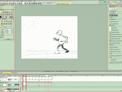

I Made 3 GIF. Showing different Animated Zooms
1.without Animated Zoom as it it now. A man Takes 2 strides.
2. Animated Zoom with focus on the Body animation. Feet sliding
3. Animated Zoom with focus on the Head Animation and Volume. Now it is easier to make subtle Head Animation
-Mads

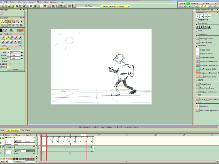

A part of me thinks so tor. The reason why I'm proposing such a feature. Is I'm not quite happy(But Generally happy I think its a great Feature that could be improved) with the out of peg feature(OoP).
Because I want to
1)Flip or Step Between my OoP Images With the lighttable turned off. and there still off peggede.
2) being able to draw on my OoP Image
2) I would like to be able to swap between my Drawings being Pegged and and Unpegged.(Checking volume - checking arc-checking volume -checking arcs.)
But that means the OoP properties must be connected to a specific Image(Like the Image marks so I guess its possibel) Instead of the Lighttable preview.
I feel This is an important feature and not overkill.
To flip between and draw on "OoP Drawings"
But how to implement that?
