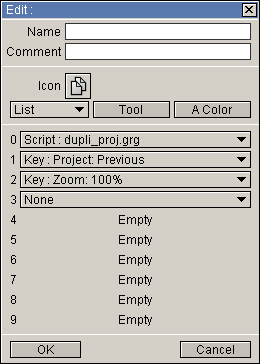

- a) if you want to open a new EMPTY project but with the same size/framerate/... than your original,
the simplest way would be to use the "template" feature.
- b) if you want to get a real clone of your original project, with its whole content,
you can try this "workaround" button (see pict),
it should give you 2 projects opened, your original (ex: "MyProject.tvp"),
and a clone, (named "MyProject.tvp -Modified- 0"), the new current one.
oh, here's the dupli_proj.grg script :
Code: Select all
PARAM none
tv_GetProjectName
mycurrentproj=result
tv_GetWidth
W=result
tv_GetHeight
H=result
tv_ResizePage W H 1
tv_LoadProject mycurrentproj
warning: it's time consuming when the project is big ...
tell me if it answers your need.

the script's last line :malcooning wrote:Fanany,
The script seems to modify the project (by this I mean that it adds to the title the word 'modified'), but all this happenes within the same project, it does not open a new one. And then, setting Key: project: Previous it focuses on the previous project of course, but that's all. am I doing something wrong?
load the original project again,tv_LoadProject mycurrentproj
so, at the end of the process, you should obtain both projects opened : the modified and the original,
at least it's what it does here...
as usually, check you haven't "space" or other illegal character in the project "full-path-name",
(it could be the cause you got only the modified)...?

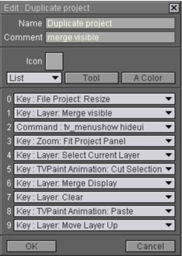

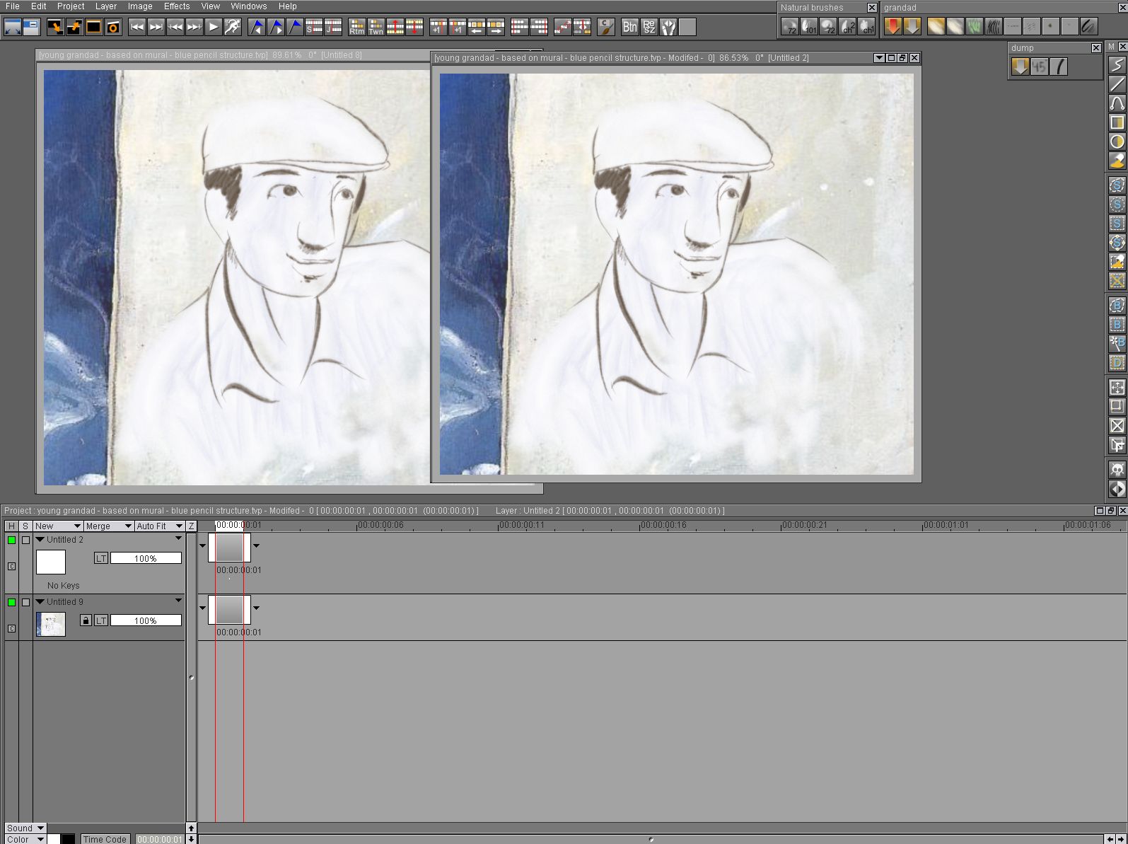

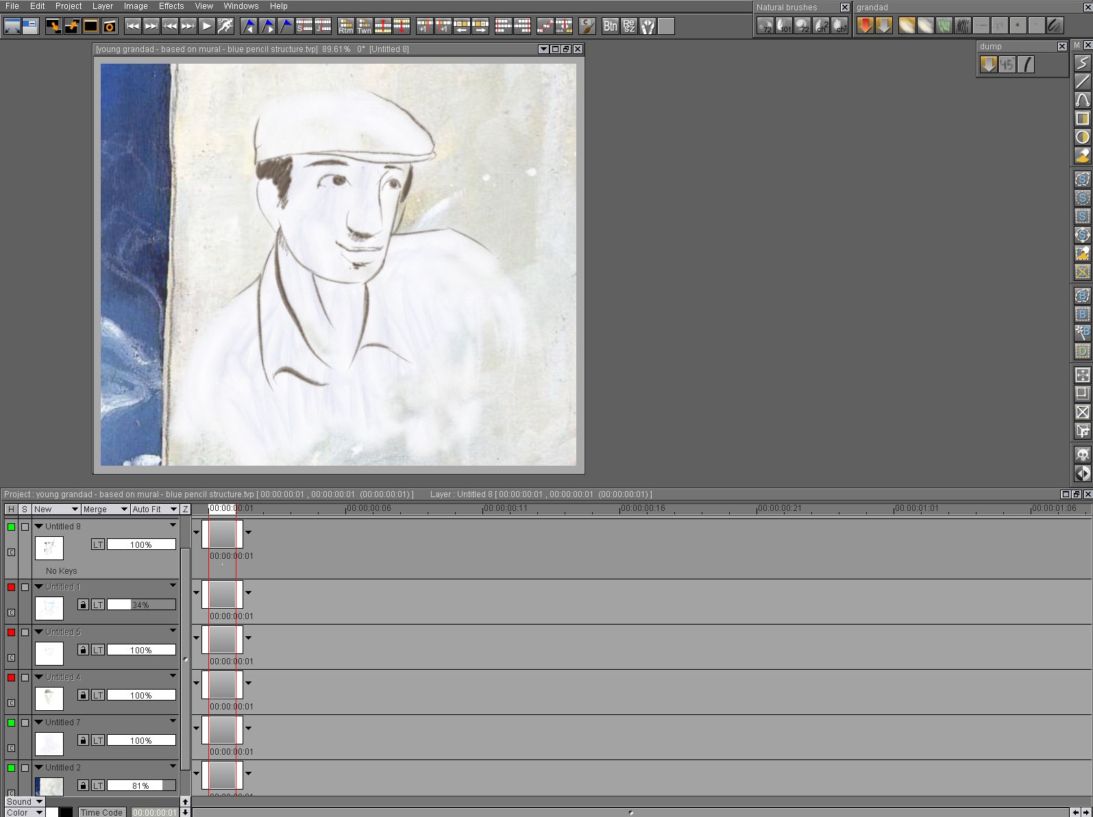

I managed to get the desired result sans-script in the end. It certainly is the longest custom button list I have made so far, and it uses all the available spaces. It look a bit rediculous, but it open a new identical project, all the visible layers are merged and the not visible ones discarded. It then has one new blank layer on top, ready to be drawn over.

Thanks,
yeah, it's supposed to be animated, so the button takes a project that might be messy with all kinds of sketching and guids, and creates a new draft, with your progress so far. I guess that for the way that I work it is a function I seem to be using very often.
TVpaint is great on that sense.
