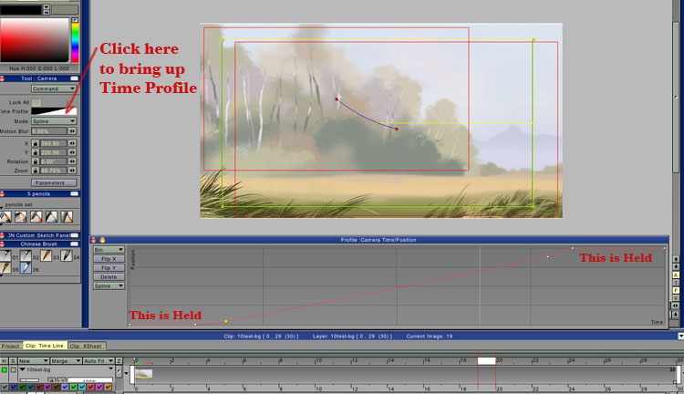

You need to make a second position to make the camera change between the two positions and follow a path. Just click a second time and you'll get the point. The path from one position to the next will take as long as the amount of frames there are in the clip, even if you click the second time while you are still on the first frame.
To create holds you must activate the Time profile. Double click on it, move it above the timeline and stretch it across all the frames. Create a curve that starts with a flat length along the bottom of the graph's field; that will be your hold. This should be enough for you to start experimenting with camera moves.

Here's what it would look like for a very short camera move spread over 30 frames, with a short hold at the start and the end of the move.
In actual practice a move like this would look better spread over more frames, but I wanted the entire thing to fit within the screen capture I
made as an example.
(click the image to see it larger)
Paul Fierlinger wrote:You need to make a second position to make the camera change between the two positions and follow a path. Just click a second time and you'll get the point. The path from one position to the next will take as long as the amount of frames there are in the clip, even if you click the second time while you are still on the first frame.
