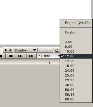

I had this question come up from a student recently, re: animating at 12 fps with single frames which would then be exported to 24fps (automatically being converted to play on "twos" at 24fps).
However, here is a problem that was encountered with TVP 9 (running on Mac OS 10.5) :

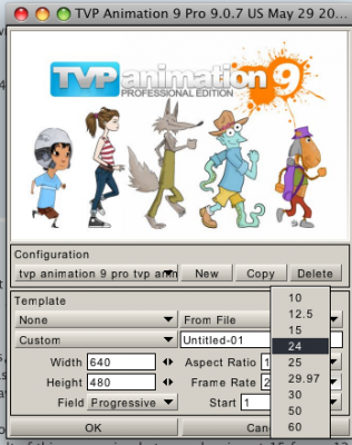

There is no option in the Start Up Panel to start a project at 12fps. The options are 10fps, 12.5 fps, 15fps, 24fps, 25fps, 29.97fps, 30fps, 50fps, 60fps.

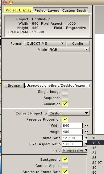

It is the same in the Export Footage To ... The option of 12.5 fps is available, but not 12fps .
Picture 2.png (39.86 KiB) Viewed 31613 times
However, the project window does give the option of playing the scene at 12 fps.
Picture 3.png (13.39 KiB) Viewed 31612 times
Is this just a Mac thing ? In the Windows version of TVP 9 is it possible to start a new project at 12 fps in the Start Up Panel ?
The only way I can see to animate at 12fps is to set the frame rate to 24fps in the Start Up Panel, then animate on singles with the Project window frame rate set to 12 fps for playback ,
then double all the frames with the Instance Panel before exporting to Quicktime .mov at 24fps.

you can always modify your project to any custom framerate including 12.
but i agree, 12 fr should be in that list of defaults.
these are probably the most often used values (in Europe anyway):
-25
-24
-12,5
-12

D.T. Nethery wrote:There is no option in the Start Up Panel to start a project at 12fps.
It's true that 12fps should be certainly appear in the list. But it's very easy to overcome this by manually entering 12 in that value box.
If after entering 12fps in the box you still don't get 12fps as the project frame rate (as it is likely so for buggy reasons), simply modify your project to 12fps, and save this as a template.
after doing this you can select that template from the startup panel, and you'll get 12fps in your project.
Good idea. I had not thought to suggest saving a modified project at 12fps as a template to open in the start up panel.
I will pass that idea along.
(BUT 12fps ought to be standard in the Start Up Panel !)

What joy! And it'll be like an egg hunt; just minutes ago I was using Modify Project where "12" is missing, a unique twist. Happy hunting! :)
