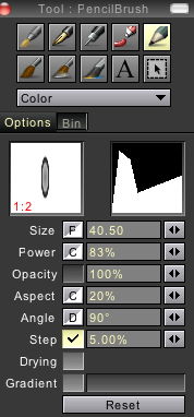

This is a paper structure which I missed a lot, but was unable to photograph satisfyingly until tody when I got a piece of cardboard which was a good enough substitute. I add my crayon settings, this is a fast tool because it doesn't use bitmaps, but delivers quite convincing results. Paper strength should be around 25 - 50%.
I always enjoyed the backgrounds Dick Ung/Tom O'Laughlin did for "The Inspector" and "Pink Panther". Just recently I learned that it was not a paper structure, but paint scratched off a cell which created the vertical linies in their backgrounds. Now this ingres paper structure is a close enough solution for me.
(I'm still a bit confused as how to save tool settings or export them. The manual gives a path where to look, but what I find there isn't named in a useful way.)

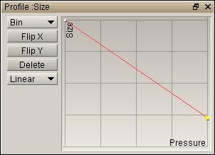

nice tool& paper Slowtiger!
When you have to do large surfaces(like the backgrounds you mention) its a maybe a good idea to change the size connection profile
so that doing broad strokes will requiere less pressure(and thus effort) and only when you need more precise(smaller) strokes you need push a little bit harder
see image:
(you do have to set the size a bit bigger....at about 60)
