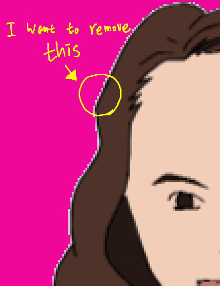

I used Luma Keyer to remove white color.
Please refer to the following picture.-the original image and the image used luma keyer
But, It is not what I wanted. The border is not clear and messy.
I know the Power Retouche Pro plugin for photoshop. This plugin can remove anti-alias.
I'd like the clear border. Because I work many images, I want to remove white color(anti-alias) at a time.
Please tell me, How to simply remove...
How to remove white color...

Re: How to remove white color...
Try "Scan Cleaner" under "Color" in FX stack.
Scan Cleaner remove other colors. I only want to remove white color (anti-alias)Paul Fierlinger wrote:Try "Scan Cleaner" under "Color" in FX stack.
OK, in that case, Importing already colored image on white BG, still remains a "2 steps FX" solution :arche75 wrote:...
I paint in demo software. Because The software can paint too easily.
* Paint overflow Detection and close fill function - This function is in TVPaint. but this is much better than the TVPaint.
so I take advantage of this software.
duplicate your AnimLayer (= sequence of your drawings),
- on the bottom one, apply a ScanCleaner FX,
- on the upper one, apply a CrossKeyer + AlphaControl FXs
then you can merge the 2 layers in one.
ps: save your FX bin for a later re-use, if needed .
