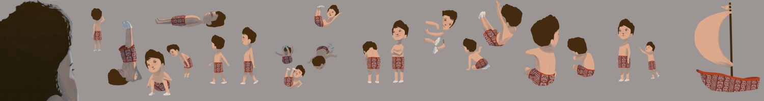

i'm glad to see my understanding of the scripts was not falling far from their logics
i've added Mads's script + layer calling line to my existing button, and it sure is an improvement in workflow.
just for reference, what I'm doing is I'm illustrating a children books of +40 pages. almost in each double-page spread the main 2 characters are showing. I'm drawing the characters on separate dedicated project (see attachment), and then I place them in the main illustration. This allows me to have each part of a character on a dedicated layer, which saves me having all the layers of the character included into the main illustration, which itself has many layers. so I have a custom panel with different tools to draw the different parts of the character (a panel for each character), and the script allows me to select the corresponding layer when I select the tool.
