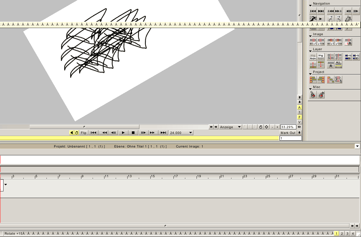

Nothing essential, but: the tooltip acts weird when I click the "15°"-button in the navigation panel, as well as the status bar at the bottom. See screenshot. (MacOSX PPC)

Hi Slowtiger,
Which version of TVP Animation do you have (8.x.x or 9.x.x) ?

9.xxx, and it's set to german right now. Sorry for my incomplete bug ticket.

What I need is the exact version of TVP Animation 9. Please replace the 'x' by the right number written in the About Panel of the software.

9.0.2

The problem comes from the character's conversion between Windows and MacOSX. Here the problem is the '°' character. You can fix it by editing the "15°" action of the navigation panel. Just replace '°' by "degree" and it should fix the display problem.
