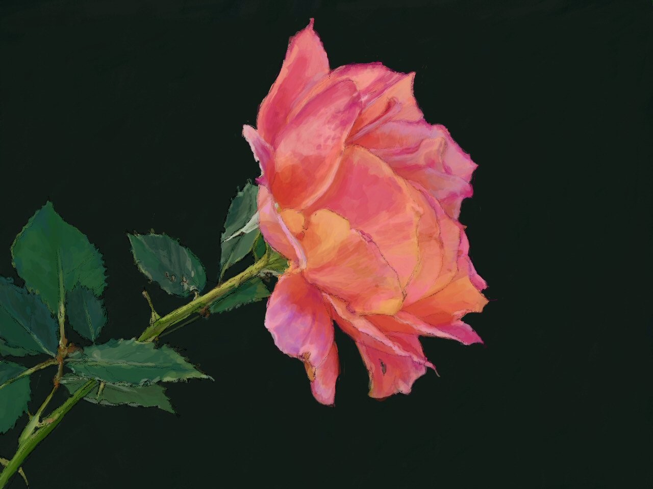

I will see if I can succeed in uploading here a couple of Sandra's earlier attempts of emulating watercolor paintings of a flower.

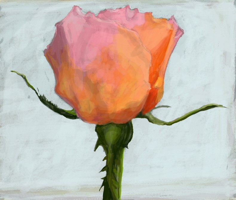

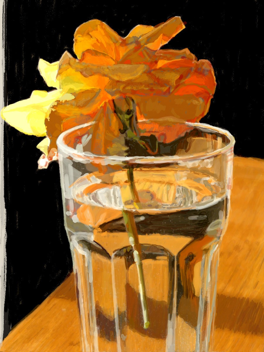

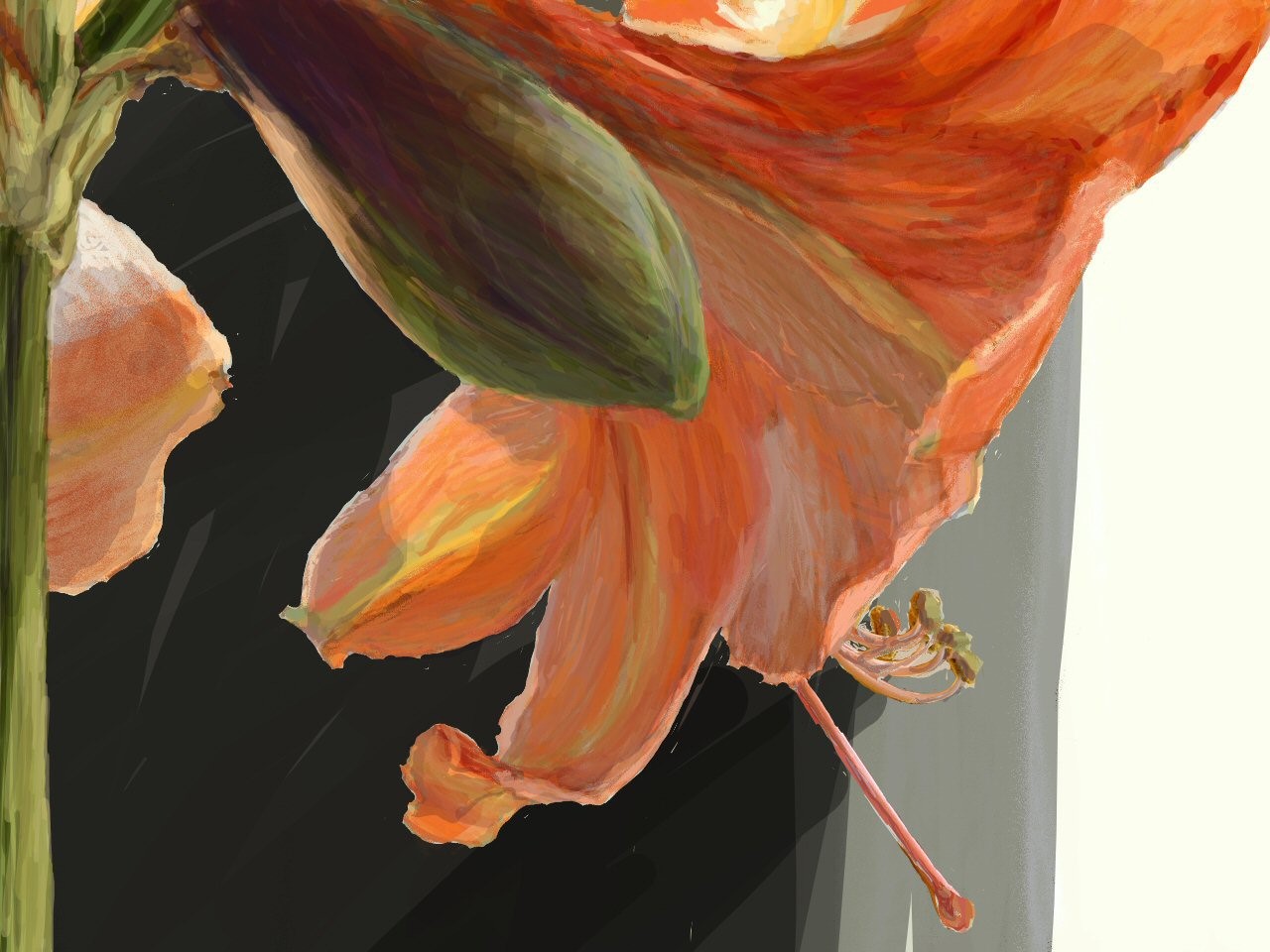

A few more; with these she began her search for whatever will come out of the software environment the most pleasing to her. She painted these a few years ago, using the pre-Mirage TVP software.

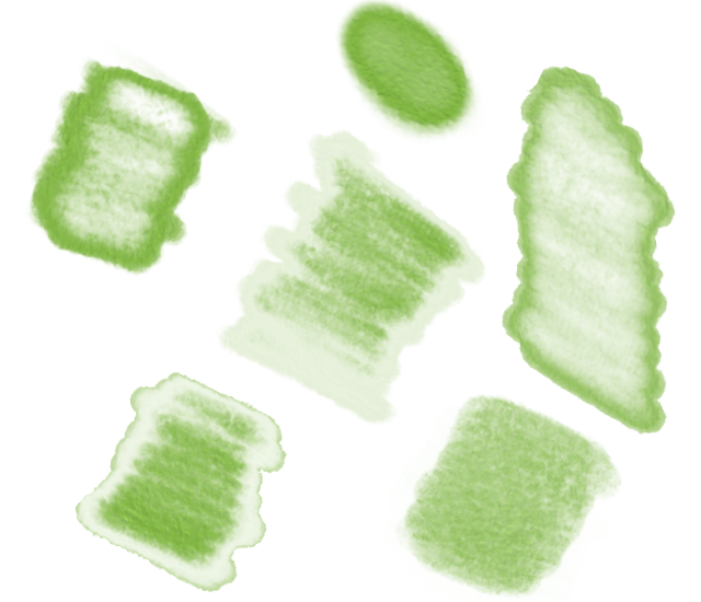

ps2: * it's amazing how we can get many different stroke result from a single and same custombrush
just by playing with the new Wet Profile setting ! (see pict.)

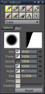

But I'm not eluding your question : to "paint" the mask (or Stencil), I would take a soft-edge brush,
something like a penbrush but with soft edge, the airbrush tool (with a profile set like in the attached pict.)
would do perfectly the job imo.
Use a bigger one to make roughly the big inner part, and a smaller size one (with Paper toggle ON) to detail the contour.
F2 shortkey to paint, F4 to erase.
