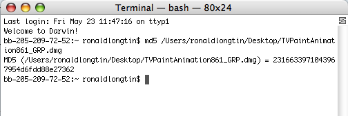

Can you try this :
Open a terminal ( /Applications/Utilities/Terminal )
In the finder, click on the .dmg you downloaded and hit Cmd-C
Go to the terminal window and type :
md5 Cmd-V (this should display the path of the dmg file, and you should have something like this in the window :
md5 /Users/Desktop/TVP......dmg )
Hit enter, wait some 10-20 secs, and post the line that it will display.

Thank you, Eric.
Here is what I got:
Here is what I got:
- Terminal.png (9.73 KiB) Viewed 18468 times
