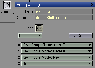

For now, this work-around should work (the beauty of the custom panel use
forget the panning tool from the main tool panel, and make yourself a panning tool like on the picture below.
I let others answer to your other nuisances ...
