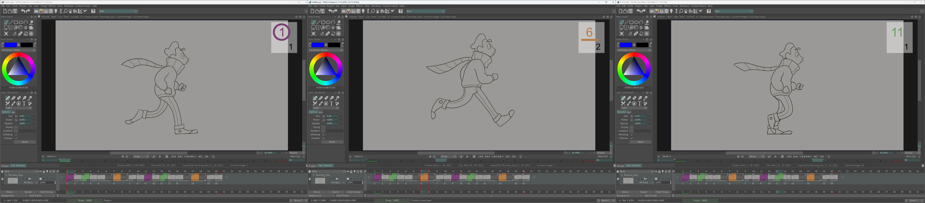

Going a bit on a tangent here, I think it could work better if the fact that an option is toggled on or off can be made clearer, and having the colour of the marking buttons (inside the panel) corresponding to the colour we selected. With a possible integration of Python in TVPaint it might be possible in the future.
Also going beyond what can be achieved with the scripting language George and this particular panel, having a visual representation, as an overlay, of the marks over the drawing area could maybe be a good addition. A visual representation inspired by the convention of an animation chart and respecting the colours chosen in the panel.
Something like this:
