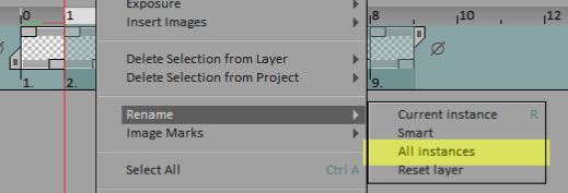

why not be consistent and have a rename option like instances have?:
rename all.jpg (12.96 KiB) Viewed 1466 times

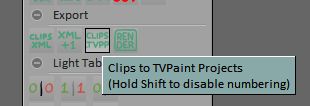

I think Lucas Sketchpanel command :
Should be integrated into the project view and also as a command in the clip menu
