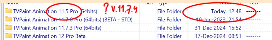

and i noticed the program file folder of the newly installed v 11.7.4 was named wrong
7-4 wrongl;y named folder.jpg (34.87 KiB) Viewed 9013 times

Isee, Windows has a tendency to install newer versions of preinstalling programs in preexisting installation folders with a similar name or to remember the last folder a program with a particular name was installed into.
This might have caused settings file conflicts.
