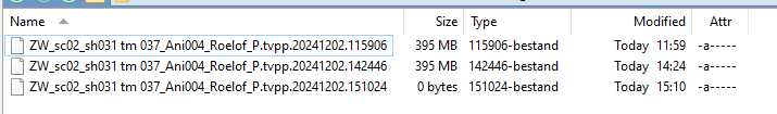

when i look in the multibackup folder i see not two earlier versions but there are three files.
one of them has the save time of the last save but is somehow zero bytes
the saved file is only half the size it should be and is corrupted as i can not load it.

Re: multisave error
So this file doesn't appear on the screenshot you posted?
You could try sending it to me via PM so we can try to save some of its content.
