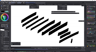

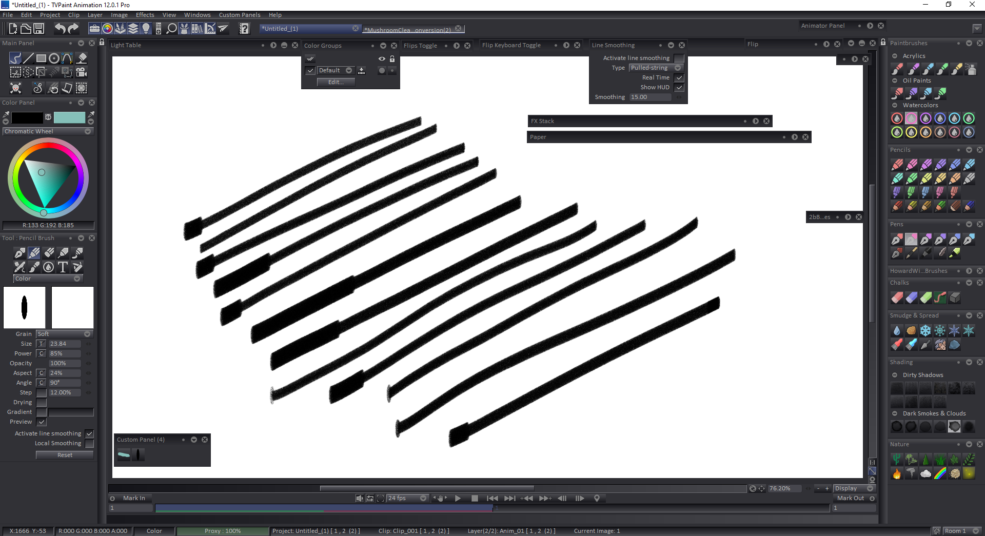

When using the built in pencil brush and setting the size to something like Altitude or Azimuth, there seems to be some problem with the initial activation starting off too strong. This doesn't happen for any other brush as far as I've experimented replicating it. It's easiest to see with the aspect flattened and an angle of 90 degrees. I've attached a screenshot of the pencil brush and a random custom brush set up similarly, and making similar strokes. You can see with the pencil there is an initial portion of the stroke that is larger than the rest, the length of it is from different speeds of stroke. As far as I have experienced it's only the initial activation causing a problem.
For reference if it's helpful I have wintab/subpixel on, but I turned it to windows ink and get the same thing. I checked my pen settings and there is nothing out of the ordinary, and this is the only brush I see it happening with.
