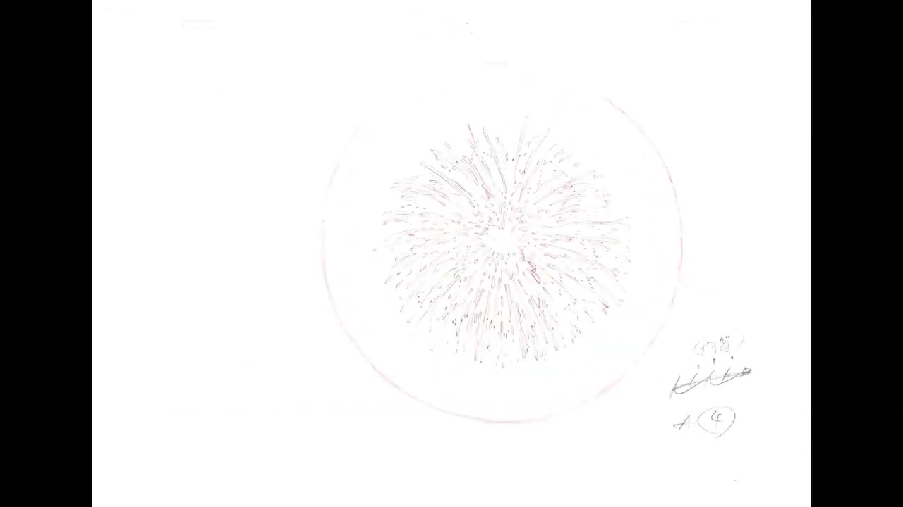

If creating the fireworks by hand is an option, in this documentary The Making of Little Witch Academia OVA from around 52 minutes til 58 minutes, is clearly shown a hand drawn animation of a fireworks, made by the animator Shûhei Handa, which can be studied.
Here is a series of clean drawings from the documentary (zip file):
Fireworks_by_Shuhei_Handa.zip
(1.48 MiB) Downloaded 214 times
On youtube, the keys , (comma) and . (full stop) allow to move forward and backward one frame. If it's not working there are plugins for web browsers, like 'frame by frame', for example.

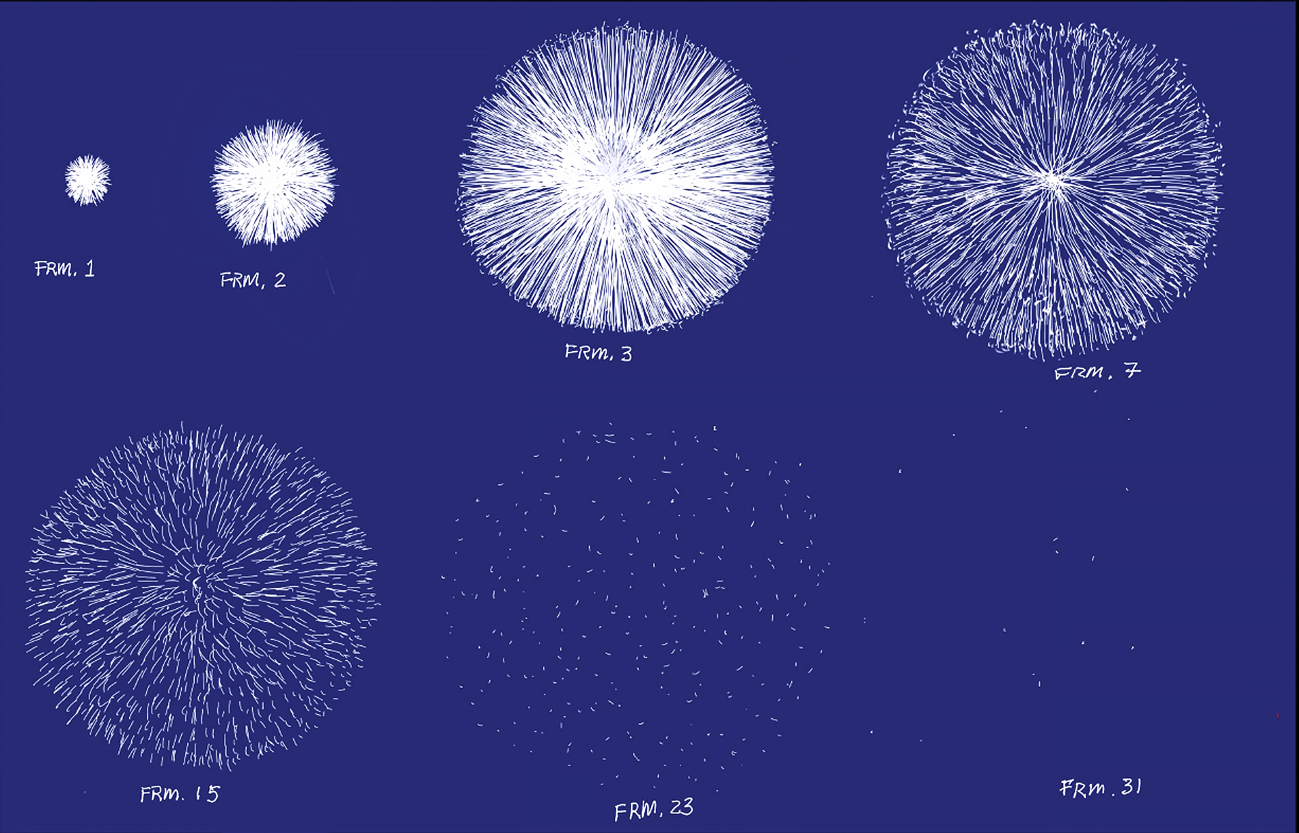

I was going to recommend getting the excellent book 'Essential Effects: Water, Fire, Wind, and More' by Mauro Maressa , because he has a section on how to animate fireworks and other explosion effects , but it is frame-by-frame , hand drawn animation technique. (attached is one image from the section on fireworks). Great book. I would highly recommend it. (if not for this project, for a future project, as a good , all-around reference book on how to animate effects). Mauro was one of the top effects animators in the business and I'm happy to say he is a friend of mine, but I would recommend the book even if he were not my friend. It is indeed an essential guide to animating effects.
(click to see larger)

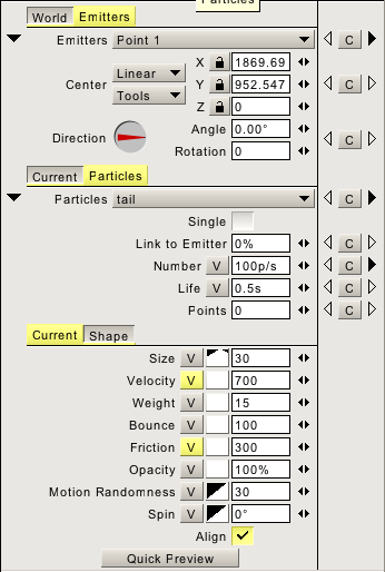

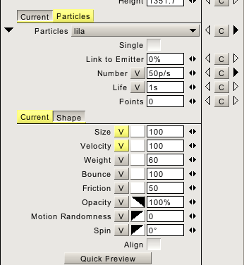

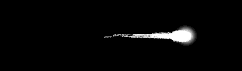

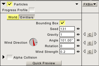

Well, here are my settings for that effect. The attached GIFs show you the elements, their explosion and fade are animated in 9 frames, these are saved as DIP and imported into the FX.
The trail is for the beginning of the explosion. You'll need to offset the different FX a bit from each other.
