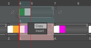

Select an image, then click and drag the image to the frame you want to copy it to , release it. There are three different modes you can choose from as you release the image:
Copy , Insert , Move . Each behaves slightly different. (see the links to the User Manual above and also see the video below).
https://youtu.be/aMnhwTnxV8M
You may also use this click & drag technique to copy or insert images from one layer to another layer.
https://www.youtube.com/watch?v=TMIIyyzQClQ
Using INSERT will add the selected frames to the existing timeline , thereby extending the layer length.
Using COPY will have the selected frames overwrite the existing frames on the timeline , and the layer length will stay the same.
