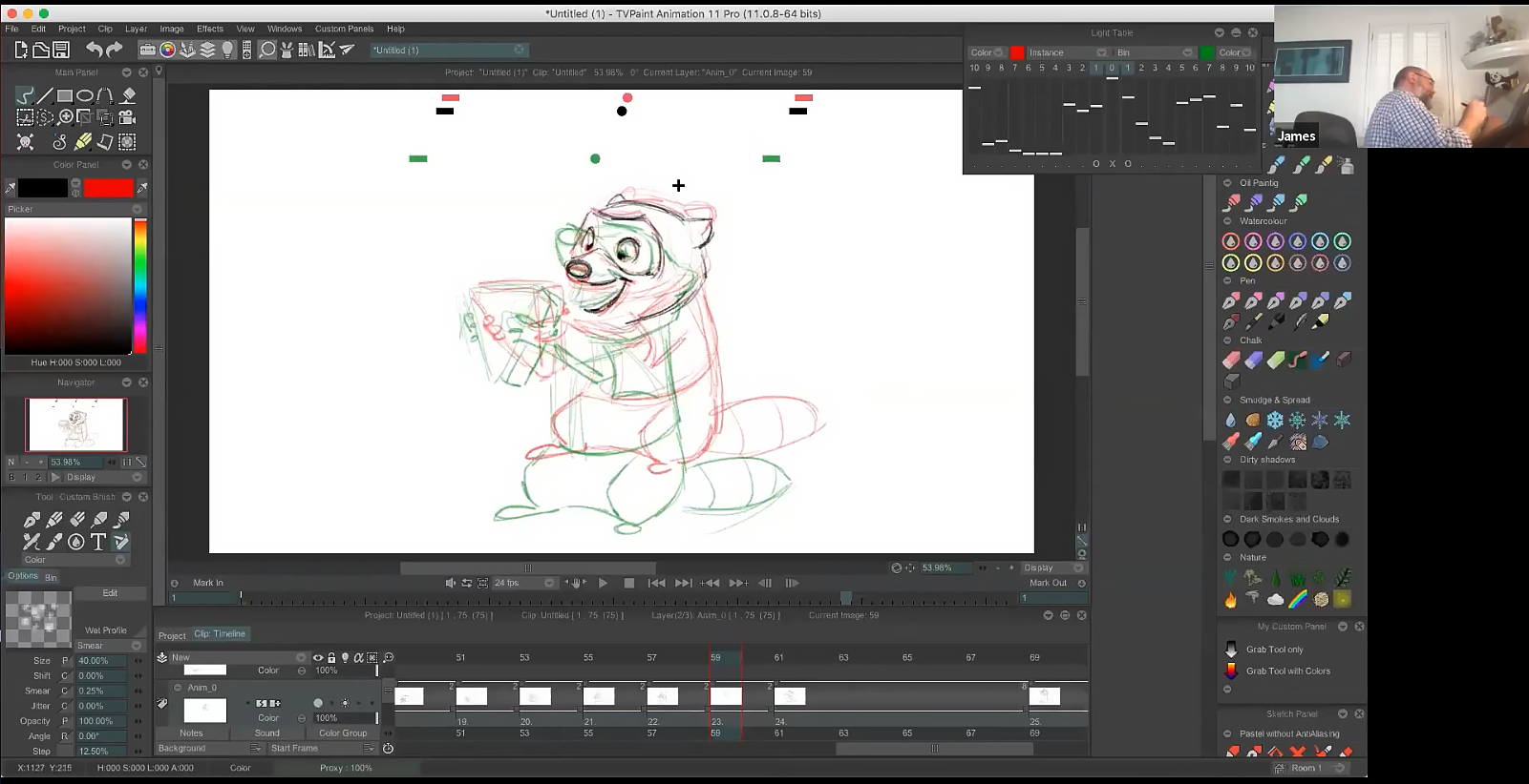

These are not "tutorials on how to use TVPaint" as such , in terms of delving into detail of how all the tools work, but watching these animation demonstrations do show the process of animating a scene in TVPaint. These are real-time demonstrations (using TVPaint) by animator James Baxter.
https://youtu.be/uyuG7T1pquw
