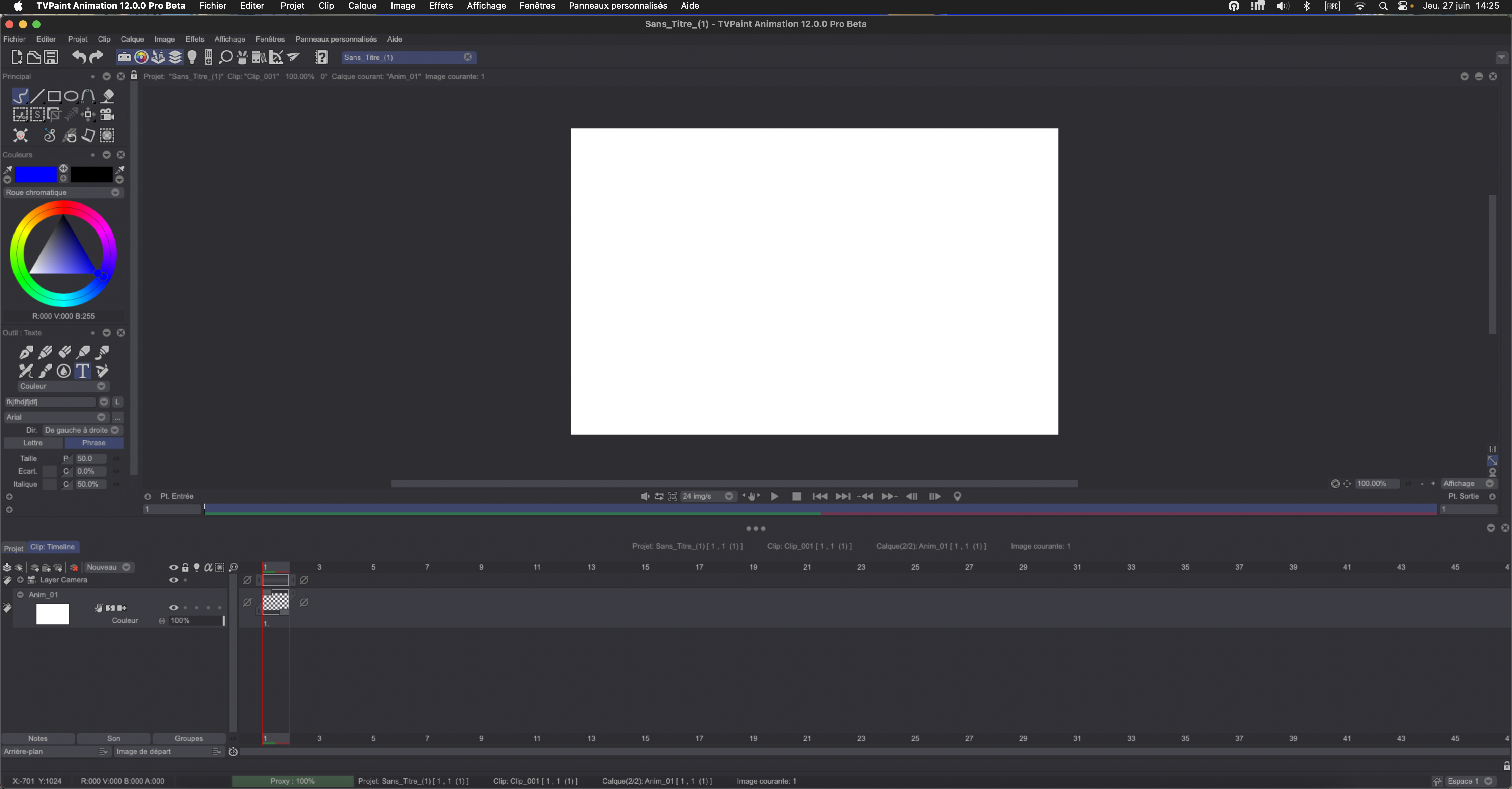

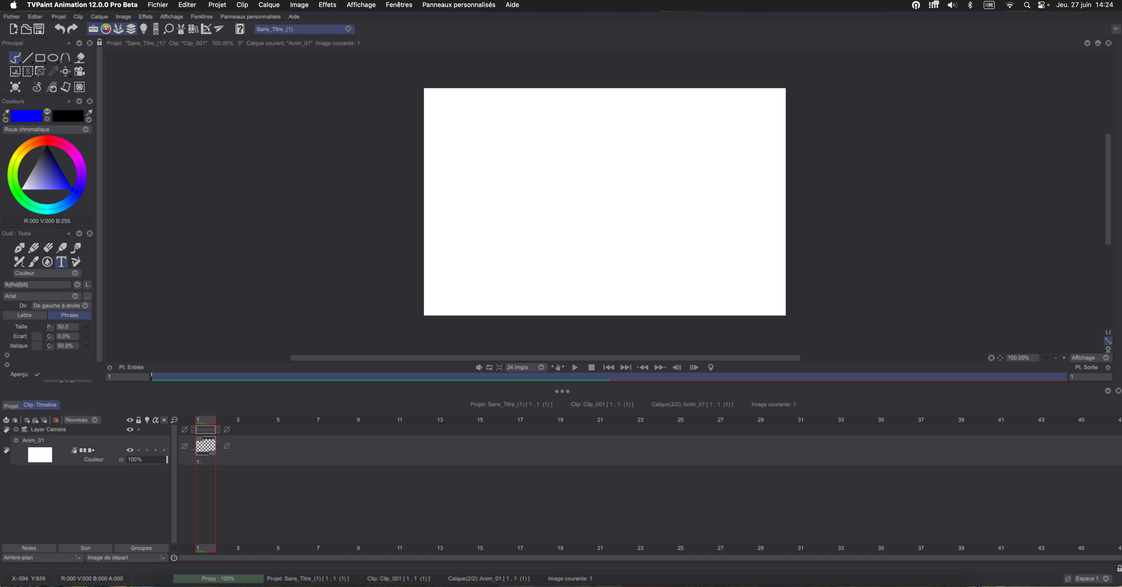

Does your TVPaint looks like this when you start it ?
I mean, is the macOS title bar (with the red, yellow and green buttons) visible ? Like on this picture:
If the title bar is not visible, please close TVPaint and then go to:
/Users/yourname/Library/
You will find a directory named "TVPaint Animation 12", it contains the software configuration. Just rename the directory into something else.
Then restart the software and load a project.
Let us know if the problem still happen or not, please.

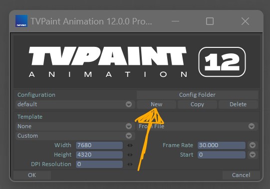

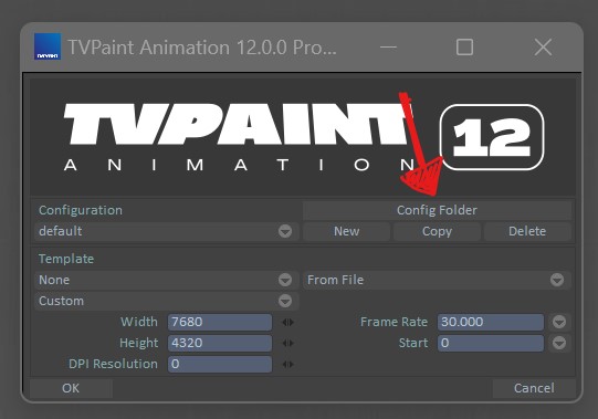

You may be able to locate the folder by using the Startup Panel. When I click on the "Config Folder" button, it opens the folder that JeremyN wants you to rename. That's how it works on Windows and I assume it will work the same on Mac.
config folder button.jpg (33.2 KiB) Viewed 4666 times
Alternatively, you could simply create a new configuration by clicking "New". This seems to be essentially what JeremyN is instructing you to do. When TVP starts, it will look for the "TVPaint Animation 12" folder. If it doesn't find one (Because it was renamed to something else), it will simply create one which, I think, is the same as creating a new configuration. Sometimes issues are caused be a corrupt config file.
Startup Panel can be enabled by going to Preferences-General-Startup Configuration
Thank you for this! This fixed it. What a strange issue.
