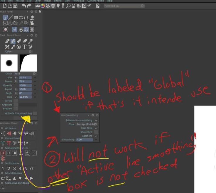

In TVP12.0.0, Right clicking on the Line Smoothing Indicator opens up the floating Line Smoothing Panel from. You can interact with the panel but it doesn't work at all, which is good, but it's confusing to have this remnant of TVP11 here so it should be removed.
Video shows me engaging the "false" panel but obviously the parameters chosen do not affect the stroke.
[Edited ] The floating Line Smoothing panel does not seem to work as I assume it was intended...
TVP12 Line Smoothing Panel Bug.mp4
(8.29 MiB) Downloaded 167 times
If the floating panel is supposed to function as Global Line Smoothing it should be given a distinctive label to make that clear. It also only works if both the floating panel and tool panels on the side are active for most tools like Pen, Brush, Airbrush.
TVP Line Smoothing.jpg (45.78 KiB) Viewed 2852 times
Also, may we please have a "Toggle LOCAL Smoothing" shortcut?. All of the current shortcuts are synced to the floating panel and there are none for the local smoothing options nor for the "Activate Line Smoothing" box in the Tools Panel.
Thanks :)

Thanks, kelanhordos. You are correct that the parameters of the floating panel do indeed work but only IF Activate Line Smoothing is also checked on the tool panel with local smoothing turned off. But there is still a problem with the implementation.
My assumption is that the way it currently works is not actually how it was intended. Or perhaps, at the very least, there should be some changes made to make it clearer.

For what it's worth, my impression was the Active Line Smoothing in the pop up panel would be a kind of global scaling for all tools that can use line smoothing, including the filled stroke, selections tool etc since these work with only the "Global" Active Line Smoothing toggled on in the pop up window.
The Active Line Smoothing in the brush section would be if you want to keep Line smoothing on for the other tools but off for brush or vice versa. For example I can have the Brush Active Line smoothing active and it will smooth my brush, but not smooth my selection tool if the "Global" Line smoothing is off in the pop up panel. As a side note this is how I personally used line-smoothing, as previously I would have a script that would activate line smoothing when I used stroke filled, and turned it off when I switched to Brush.
The Local smoothing would then be an option to override the "Global" settings so you could have a different setting for each brush that has a local setting you can activate.
That seems to be how it is working for me, and given the way I was using scripts before to accomplish a similar feat it feels like it's working, but I can understand it seeming redundant in your example.
