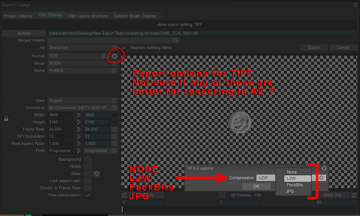

If exporting images to TIFF format for use in After Effects (as David Zwar recommends, instead of PNG) , what TIFF compression is optimal for AE ?
TVPaint offers these options for TIFF:
None
LZW
PackBits
JPG
For use in After Effects does anyone know the difference and the advantages/disadvantages of using one or the other of these compression options for TIFF ?

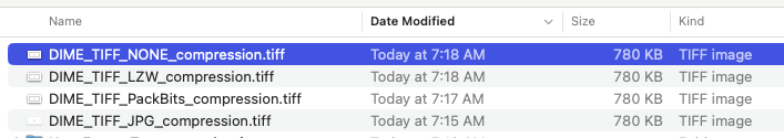

In a test I did there was no difference in file size of an image exported to TIFF with None , LZW , PackBits, JPG compression options. The file size was 780 KB for each.
TVPaint TIFF exports_same_file_size.png (32.12 KiB) Viewed 44261 times

Interesting. According to an old French forum post I found, LZW seems more adapted for cartopgraphic images (so flat colors).
The first 2 algorithms are "lossless", but the absence of a difference in file size is intriguing. Maybe they should be tested with more visually complex projects.
Edit: I didn't see that David modified his post before sending my response. Thank you for these additional tests

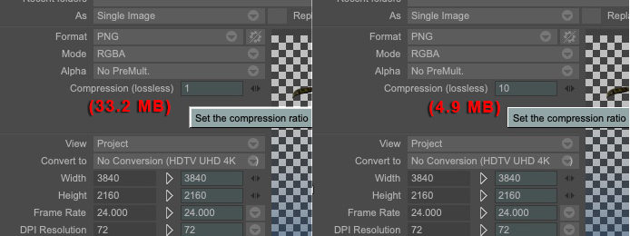

Dean wrote: 01 Feb 2024, 15:22 Hello David, this is something that will be discussed again during v12's life cycle, as it won't make it to v12.0.
I still hope that PNG export settings can be fixed as soon as possible. (it's not a minor bug, because some clients specifically ask for image sequences delivered as PNGs, even though all testing suggests that TIFF or TGA is better.)
I notice with Photoshop the difference between using their Smallest File Size (slowest to save) and Large File Size (fastest to save) settings doesn't have as great a difference in file size as TVPaint. A test using Photoshop's Smallest File Size setting resulted in an image size 5.7 MB and the Large File Size was 6.6 MB.
Photoshop PNG_Export_Settings.jpg (39.99 KiB) Viewed 37441 times
Whereas the same image saved from TVPaint results in file size of 33.2 MB (Setting 1 = largest file/fastest save) vs. 4.9 MB (Setting 10 = smallest file/slowest save). That's a HUGE disparity.
(TVPaint does better compressing at the smallest file size setting: TVPaint 4.9 MB vs Photoshop's 5.7 MB , but at the larger file size setting TVPaint's 33.2 MB vs. Photoshop's 6.6 MB) .
