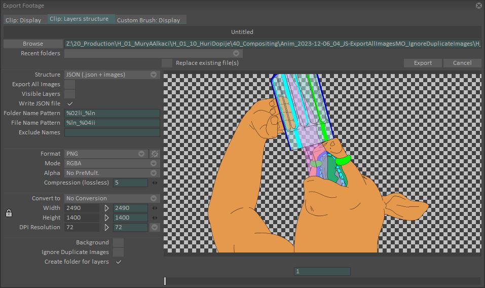

In my TVP PRO 11.5.3, I'm using this settings:
- Export All Images: Yes
- Ignore Duplicate Images: No (because that seemed to be the cause of AE import errors previously
And this settings seemed to be working for a long time. Meaning the result is limited number of PNGs + JSON that work correctly on AE import.
BUT
my colleague who uses the updated TVP STD 11.7.2 with the same settings (Export All: Yes, Ignore Duplicate: No) will not get limited number of PNGs but a PNG for every single frame of the timeline, obviously bloating the export times and sizes a lot. So suddenly we can't use our tested settings that used to work. We tried changing the Export All Images to No, keeping Ignore Duplicate on No:
Which resulted in nicely limited number of PNGs that are sadly useless because they are not imported correctly in AE (it causes the incorrect timing errors reported previously ).

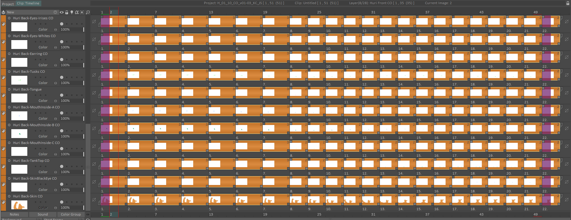

Specifically - this timeline (which contains some empty instances):

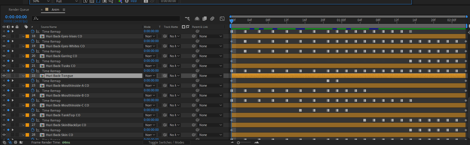

... was reconstructed by the JSON AE import this way (omitting the empty instances, but messing up the timing of non-empty ones)

After some more testing and reading I can be more specific about this problem – I think what I need is to be able to check both: Export All Images AND Ignore Duplicate Images.
Because obviously the AE import script fails reconstructing empty instances when it doesn't have an empty PNG for them (I was surprised to find out that there seems to be no instances' durations data stored in the JSON exported from TVP 1.7.2, only timing of the "heads" of non-empty instances is defined duplicitely there and in images' filenames), so I do need the Export All Images checked.
But I also need the Ignore Duplicate Images now – after the Export All changed behaviour in new version(s) of TVP – to prevent exporting every single frame of the timeline, bloating export times to "infinity".
Sadly, being able to check both at the same time is another thing that changed in the new TVP version. Now they are mutually exclusive. This seems to be blocking the only workable way for us.
