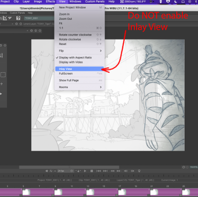

Oh no, I have the same problem from.... 2015.
I looked everywhere but I can\t find the little icon on the top left David_fine was talking about.
I've attached a screenshot of my current workspace.
How do I get back the control bar/ that bar that has the rotate icon, and mark in/mark out buttons?
Thank you for your help!
Mac OS Monterey 12.6.7 Macbook Pro 2021 M1 Max, 32GB Memory
TVPaint Professional 11 Wacom Cintiq Pro 24
Posts: 4272
Re: Control bar gone!
kiyaa wrote: 07 Nov 2023, 22:08 Oh no, I have the same problem from.... 2015.

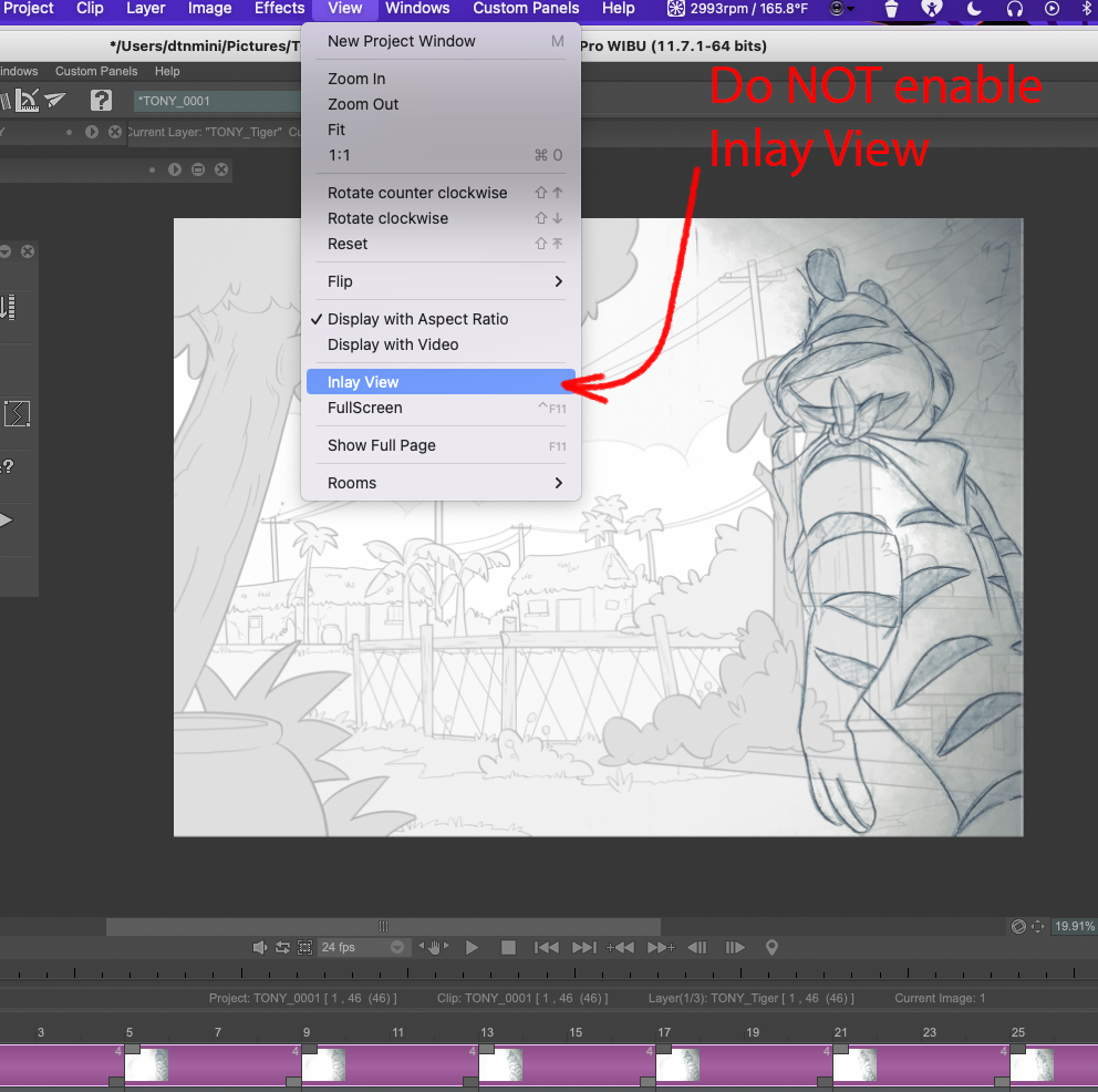

You have fallen victim to the dread Inlay View . Under the View menu , make sure that Inlay View is NOT checked.
See attached screencapture movie showing how Inlay View can happen. (also how the Preview/Play bar will disappear at times if you press certain buttons).
TVPaint_Escaping the Dread Inlay View_.mov
(11.06 MiB) Downloaded 349 times
