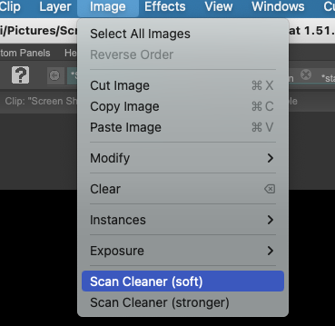

Image > Basic Scan Cleaner. See manual for more options.

Or as Slowtiger mentioned, just use the preset version of Scan Cleaner from the Image menu. There are actually two Presets: Scan Cleaner (Soft) and Scan Cleaner (Stronger)
Screen Shot 2023-09-01 at 8.31.44 AM.png (60.02 KiB) Viewed 2111 times

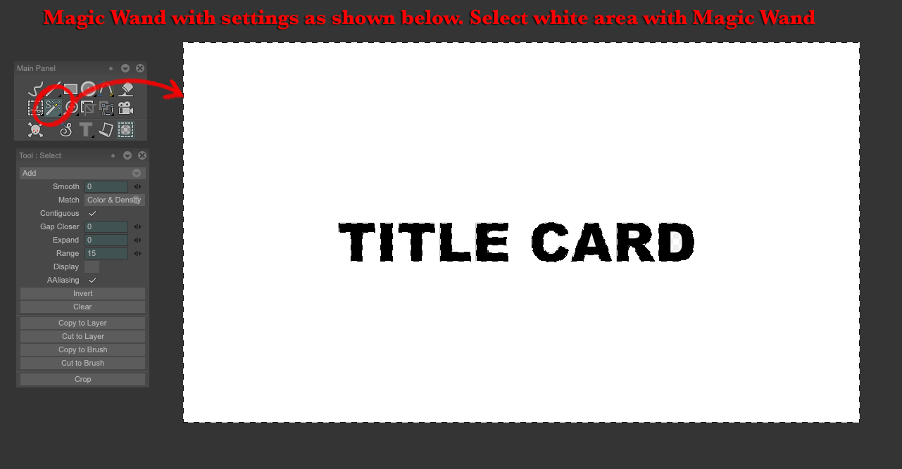

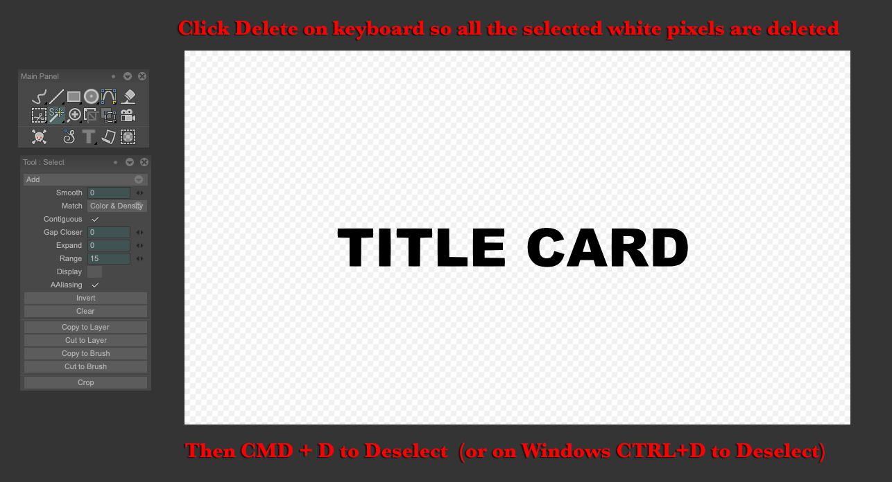

Another option for what you are describing is to use the Magic Wand Selection Tool to select all the white area around the Type , then click on Delete , which deletes all the selected white area.
Screen Shot 2023-09-01 at 8.36.49 AM.png (71.83 KiB) Viewed 2108 times
But Scan Cleaner is probably easiest for what you need to do.
