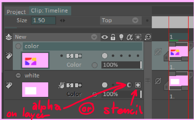

- Posts: 4519
Re: Coloring "rough" drawings-Open lines all over
good news...
those are perfectly neat lines!
With this line quality, using the method i described, coloring the whole animation white can be done in mere seconds.
Not exaggerating!
Then use alpha lock on he white layer and color there.
Or... if you want to keep the white, activate stencil mask on the white layer and color on a separate layer above it.

- Posts: 4519
and i just remembered another great coloring tip...(TVPaint has so many functionalities if i don't use them regularly i tend to forget them!)
its called Autopickcolor and it will help you further speed up the coloring process!
see video: i noticed obs did not record the layer panel... it was just two layers:
