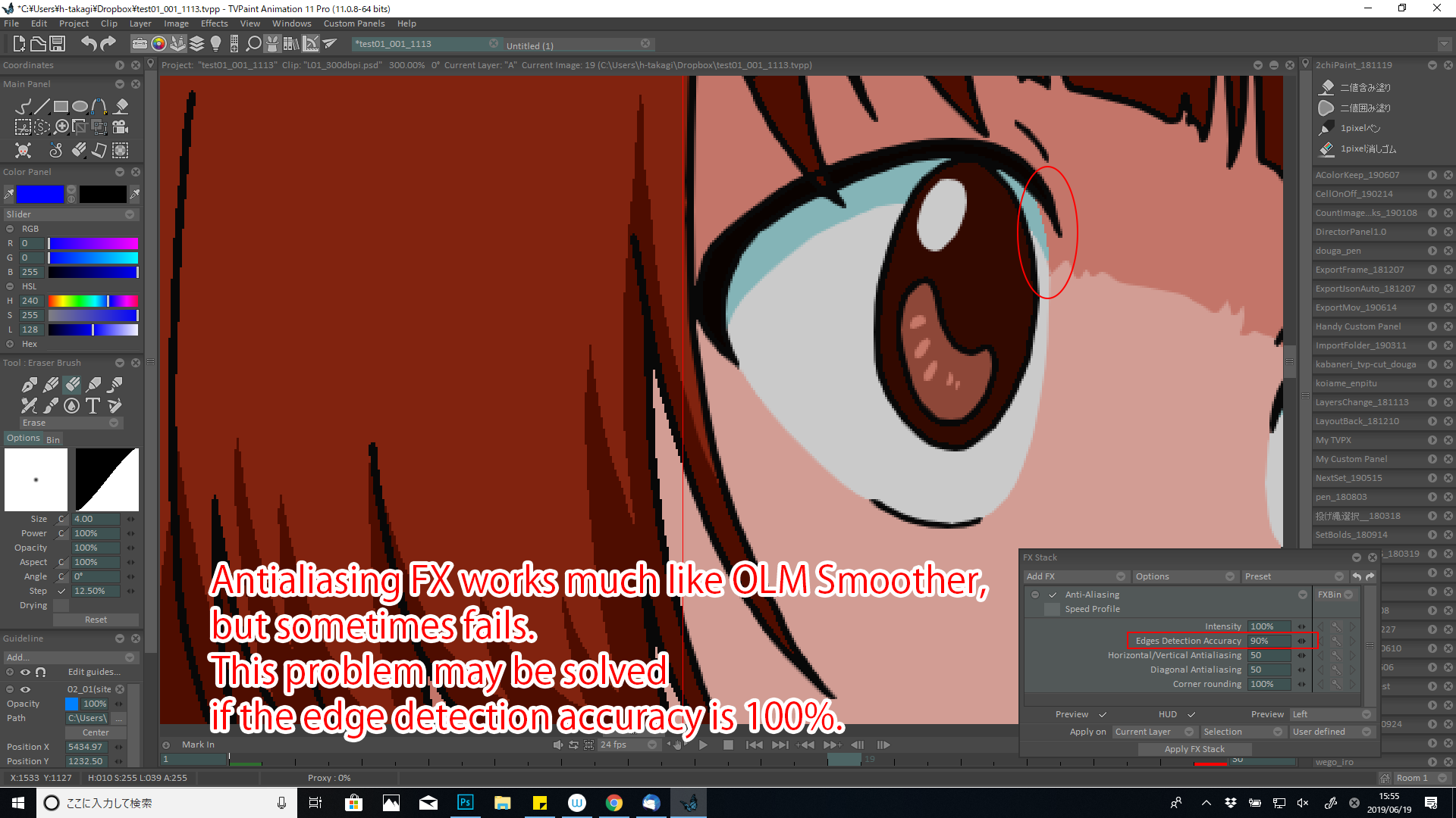

It is possible for TVPaint's anti-aliasing FX to be close to "OLM Smoother".
However, it requires careful handling to use.

I think that the initial value is enough, because items other than "Edge detection accuracy" do not know the effect even if you change them.
Whenever you want to add a blur effect to your drawing, perform blur after antialiasing.

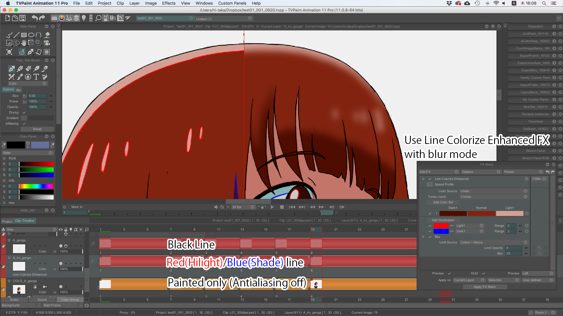

Sorry, TVPaint have "Line Colorize Enhansed" FX on 11.0.6 look like "OLM blur" .
The difference with OLM blur is that instead of applying blur between the two colors, blur is applied across fill lines.
