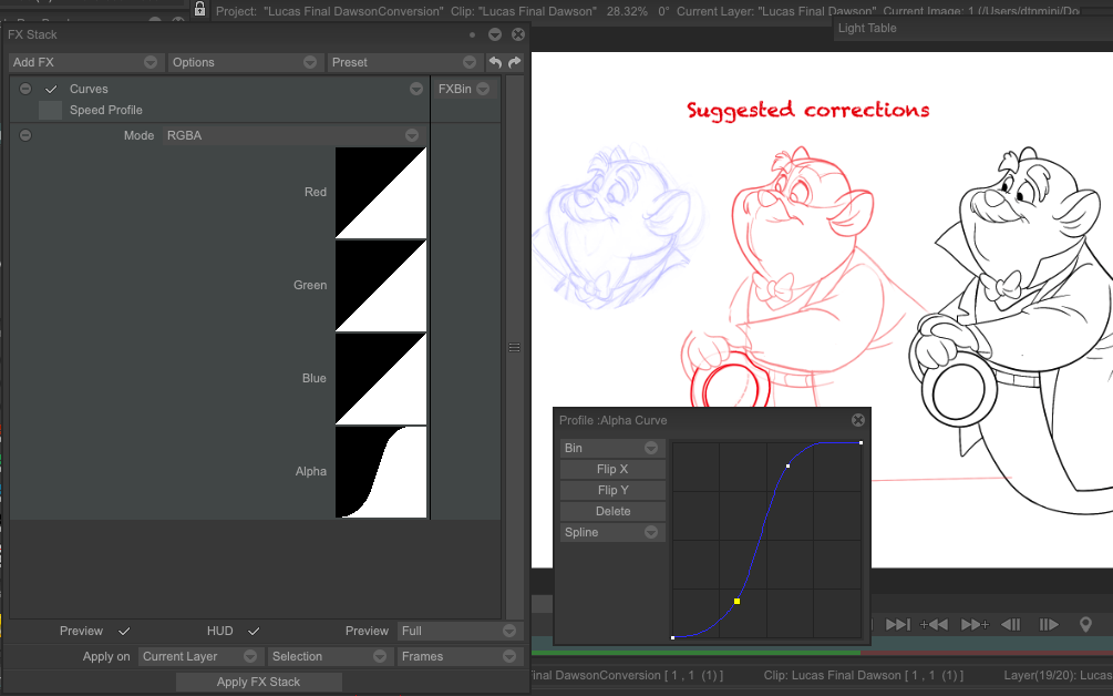

Tsuchida wrote: 24 Oct 2023, 13:21 I was wondering if you could help me with the blurring of pixels when rotating a TVPaint image.
Which version of TVPaint are you using? Recent update 11.7.1 has somewhat improved the blurred pixels from multiple transformations issue.
Make sure you are updated to 11.7.1 .
Also , you can use FX Stack > Color > Curves > Alpha to add some sharpness back into the line if it has been blurred.
OR use the drawing blend mode SHARP. See this little demo I made of using SHARP blend mode.
