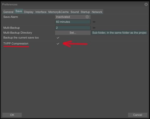

Does this lag occur with every file you open in TVPaint or does it happen only with this animatic file ?
In Preferences under Save do you have TVPP Compression enabled ?
TVPaint - Use TVPP Compression.jpg (19.39 KiB) Viewed 2733 times

It's with every file. Yes, I have the compression enabled.
