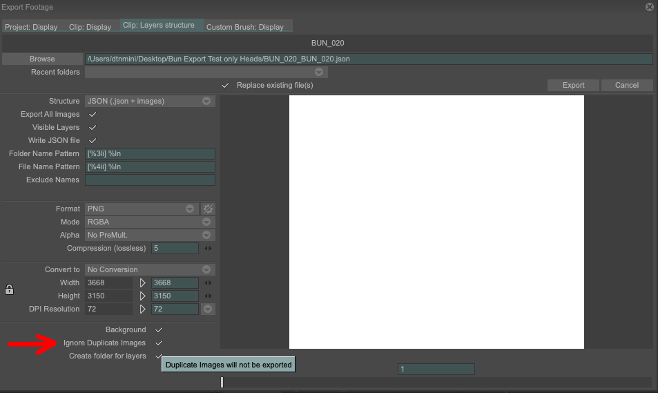

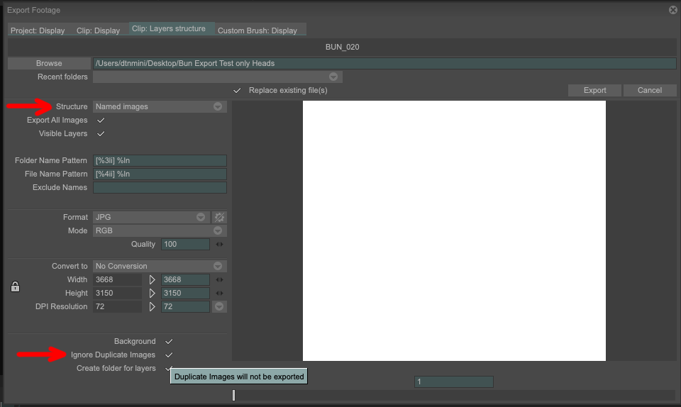

Yes. Export > Clip Layers Structure > JSON . Make sure you check the box next to Ignore Duplicate Images.
This will export only the heads , not the exposures.

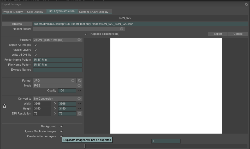

If you prefer JPG instead of PNG , switch it to JPG -

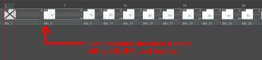

Or the other option (if you don't need the JSON file to import the images to After Effects or some other app) is simply Export > Clip Layers Structure > Named Images.
This requires that the Images have a name. In this case I've attached the prefix BN_ to each instanced on the Timeline.

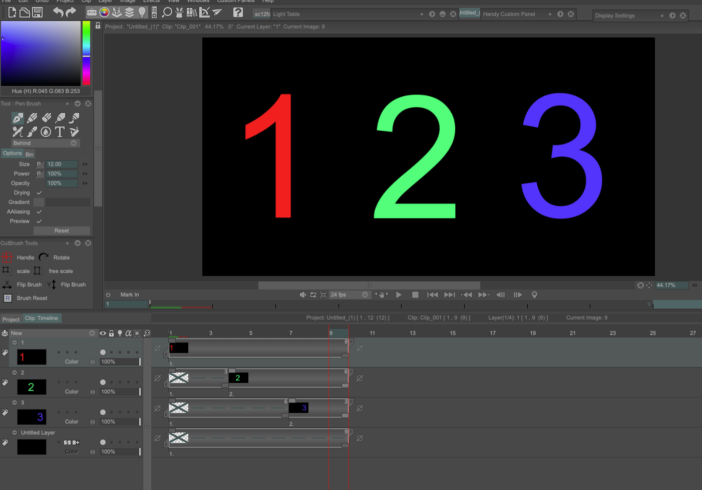

So here is a clearer example of what I want: I only want to export the green columns, with layer data intact and visible:
So essentially only three frames exported with all layers visible. Frame 1 only has the number 1 visible, Frame 2 has 1 and 2 visible, and frame 3 has 1, 2, and 3 visible.

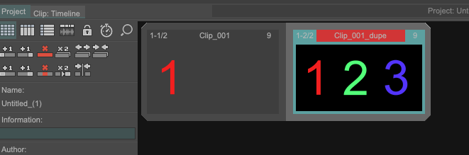

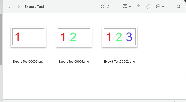

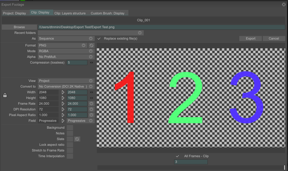

Would this work for what you want ?
Here's the original scene set up -
Duplicate the clip -
duplicate clip 1.png (31.17 KiB) Viewed 3750 times
duplicate clip 2.png (24.5 KiB) Viewed 3750 times
Now in the duplicate clip change the exposure to this:
change exposure on duplicate clip.png (37.07 KiB) Viewed 3750 times
Export -
Which results in these exported frames:
exported frames.png (28.31 KiB) Viewed 3750 times

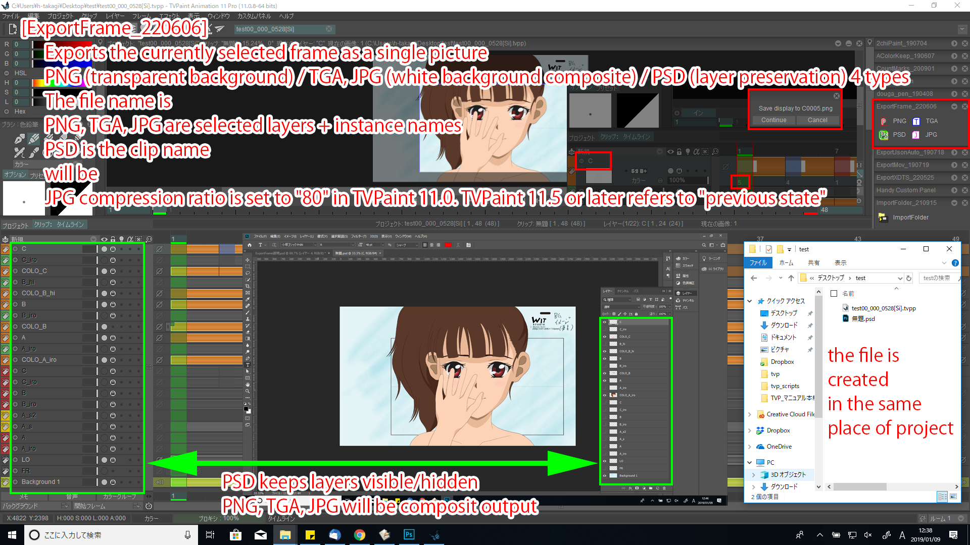

Although it does not satisfy all your wishes, I have created a panel that exports the composite state of all layers on a frame-by-frame basis with a single button.
Try the attached panel.
