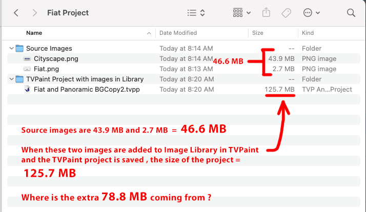

Something seems off. Here is a simple test I did this morning:
1.) I have two source images , one is 43.9 MB , the other is 2.7 MB (46.6 MB between the two of them)
2.) I placed both those images in the Image Library.
3.) There is nothing else in the TVPaint Project, only a single blank layer (I have not yet placed the source images from the library into the timeline using KeyFramer or Custom Brush)
4.) Now I save the TVPaint project. The size of the project shows as 125.7 MB. All it has in it are two images in the Image Library which total (46.6 MB . Where is the extra 78.8 MB coming from ?
Screen Shot 2023-04-04 at 8.21.17 AM.png (46.72 KiB) Viewed 5949 times

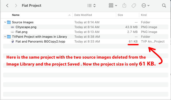

5.) Now if I delete the two source images from the Image Library and Save the project again the size of the project shows as 61 KB.
Screen Shot 2023-04-04 at 8.38.26 AM.png (40.63 KiB) Viewed 5949 times
