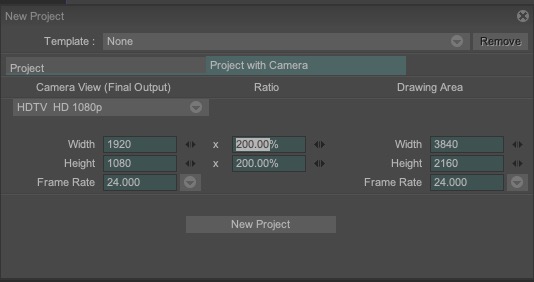

Create a New Project. Project with Camera view . 1920 x 1080 x 200% = 3840 x 2160.

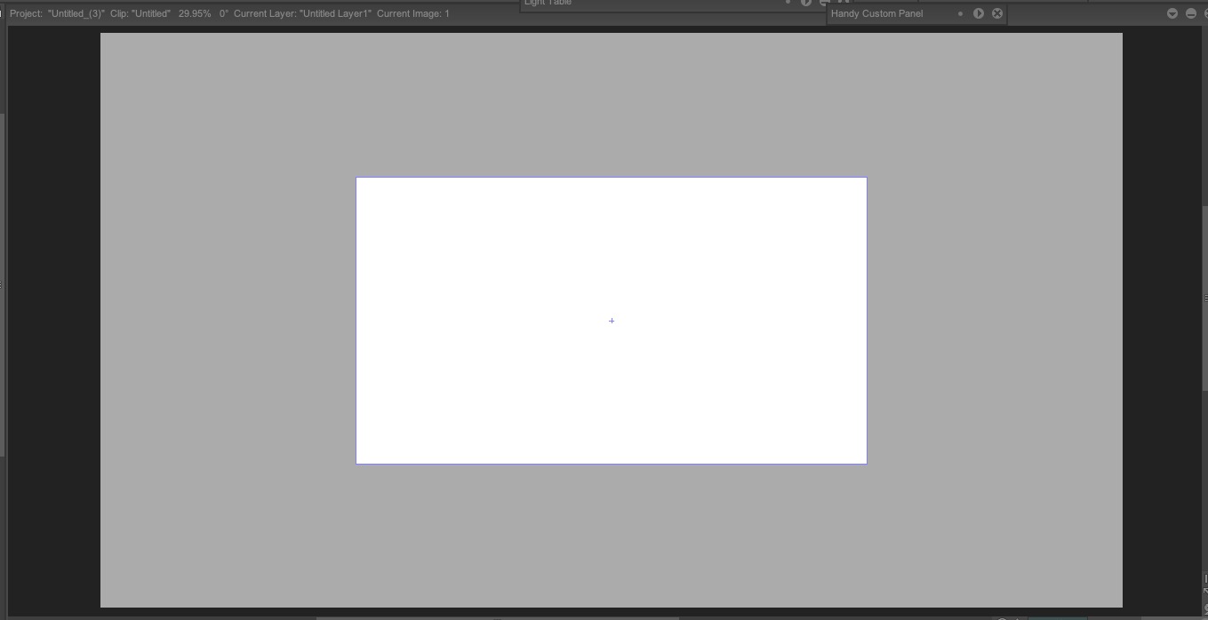

It looks like this:

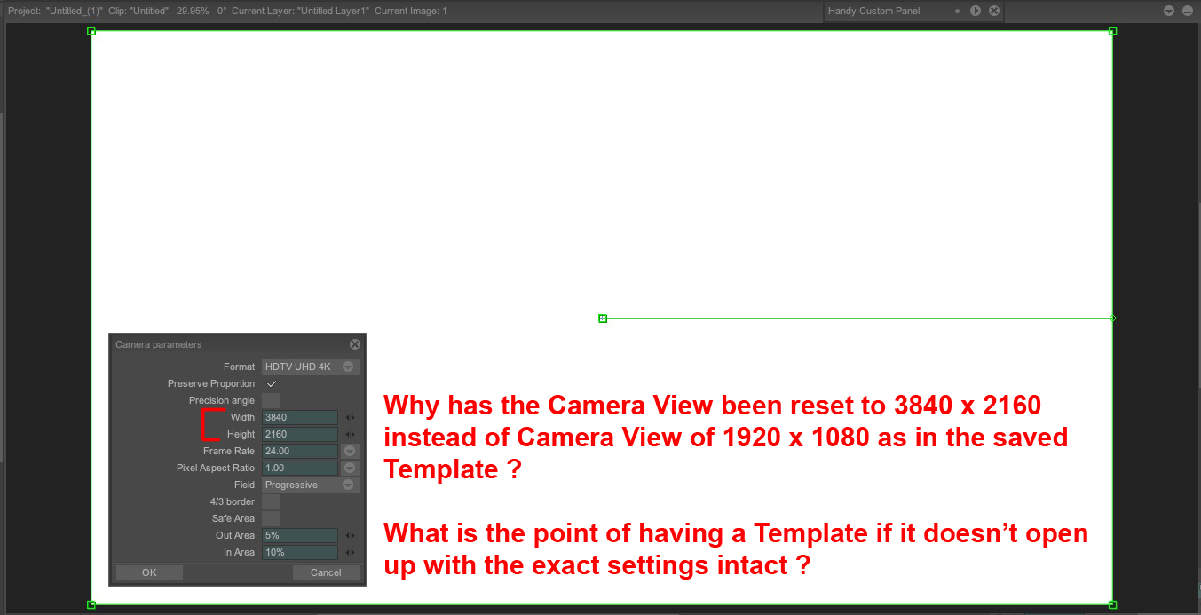

However, when I open TVPaint the next time it opens a project size 3840 x 2160 with the camera view set to 3840 x 2160 , not a camera view of 1920 x 1080.
TVPaint did not open the saved Template. Or if I had it set to Remember Last Used Configuration the same thing happens: it opens a project 3840 x 2160 with the camera value reset to 3840 x 2160 not to 1920 x 1080. So the problem is that TVPaint does not remember the Template or the Last Configuration Used , because the last configuration used had the camera view set to 1920 x 1080 , not 3840 x 2160 .

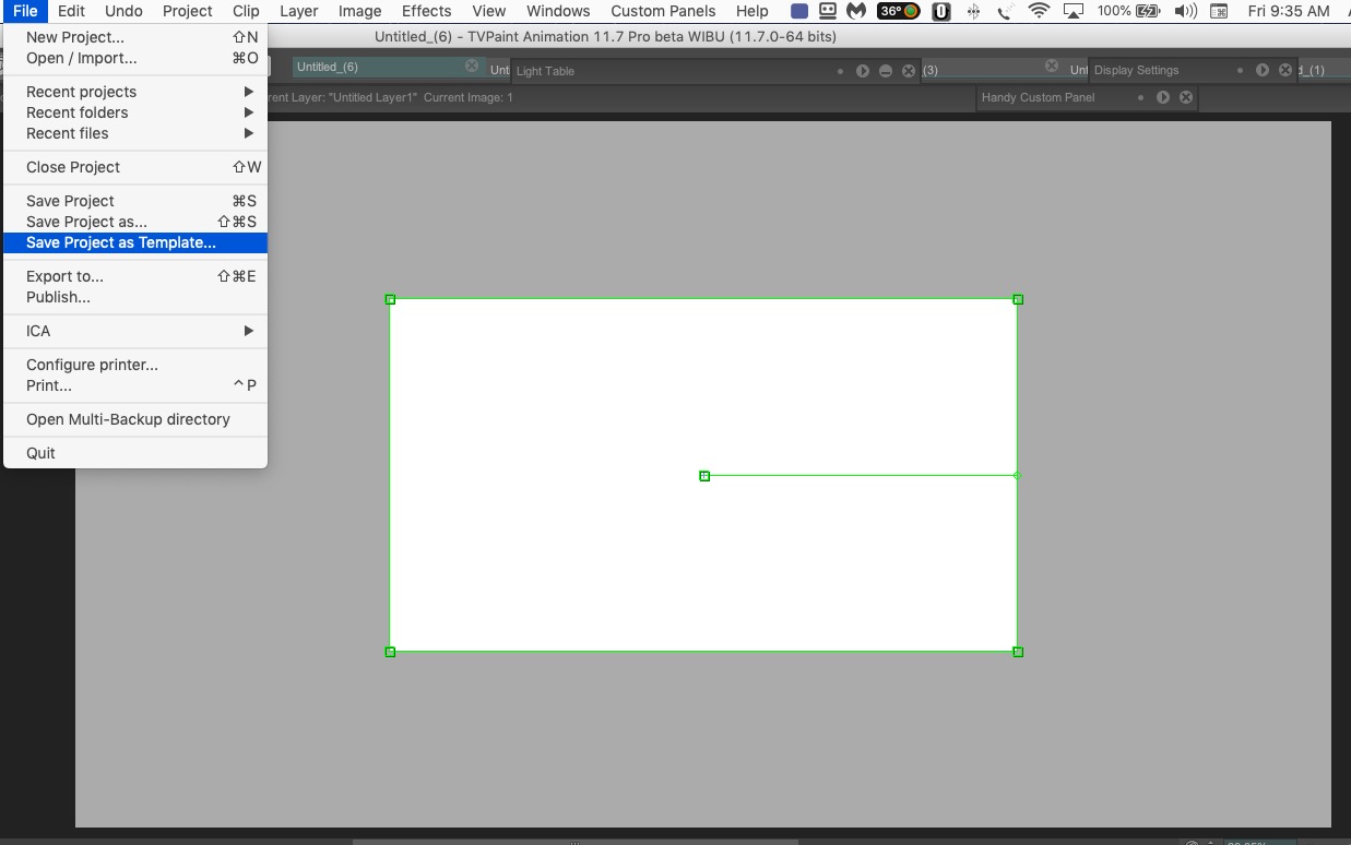

Here is another problem with TVPaint not remembering the template dimensions:
I create a New Project with Camera View of 1920 x 1080 , at 200% overscale , so the canvas size is 3840 x 2160 .
Create new project.jpg (22.91 KiB) Viewed 2860 times
Save as a Template named 1920x1080 Camera
save project as Template.jpg (91.46 KiB) Viewed 2860 times
