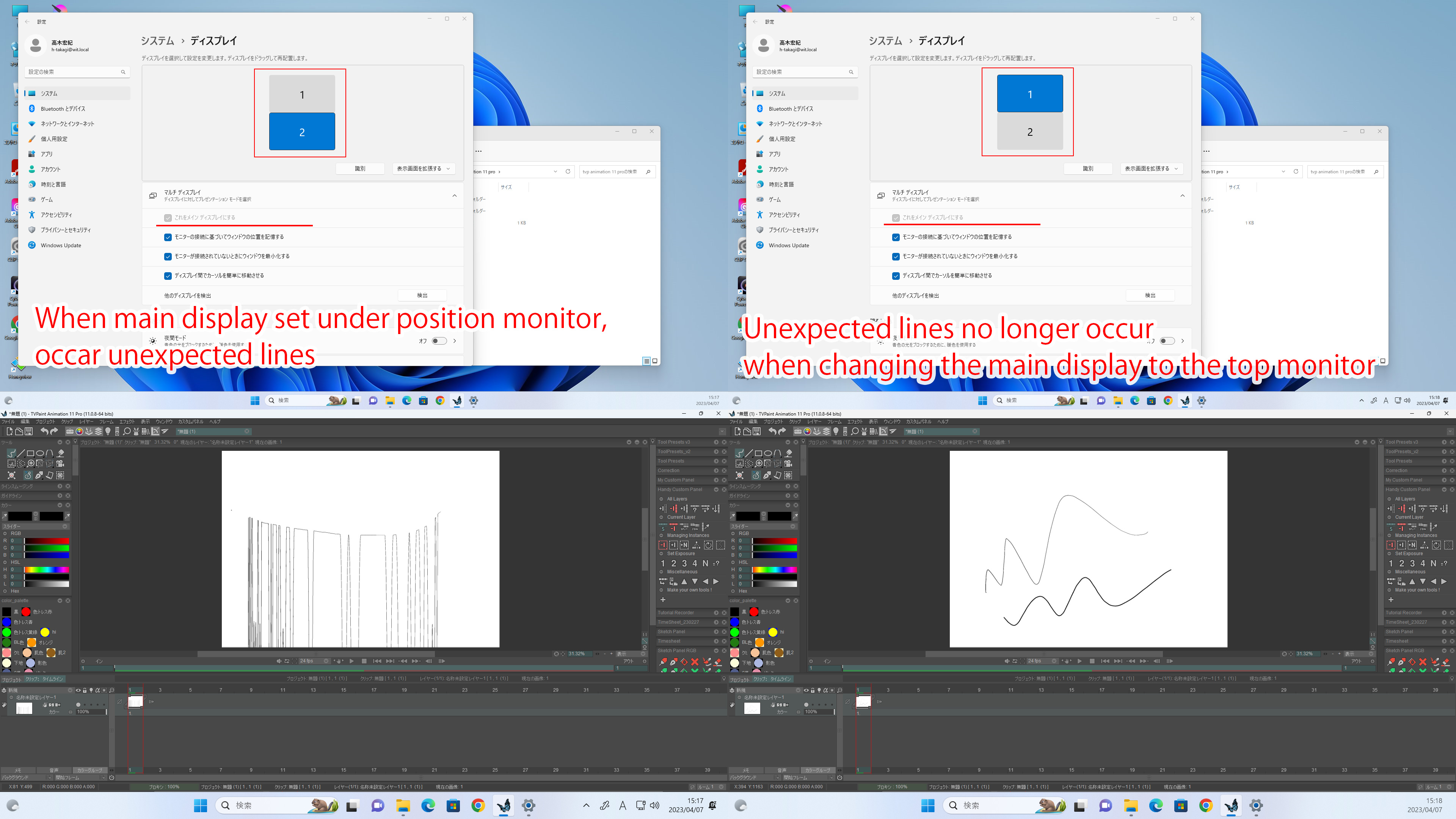

We had this problem in our studio as well.
We installed TVPaint 11.0.8 on a PC with Windows 11 installed in order to distribute equipment to new animators. At that time, the settings folder duplicated from TVPaint 11.0.8 on Windows 10.
When Wacom Cintiq 16 (DTK-1660) was used under these conditions, unnecessary vertical lines were drawn simultaneously on multiple computers.
conditions are:
- Using multiple monitors
- Place Cintiq on the bottom and other monitor on top to match physical monitor placement
・I set the Cintiq (bottom row) monitor as the main display in the Windows display settings.
Changing the other monitor (top position) to be the main display resolved the issue.
I don't know at this time if this solution applies to all similar issues I've encountered.
We would appreciate it if you could consider fixing this issue in the next version upgrade of TVPaint 11.7.
