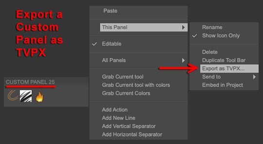

These screenshots show what happens when saving the Custom Panel as TVPX:
Let's say I create a new Custom Panel and I give it the name Custom Panel 25. Then I click on Export as TVPX .

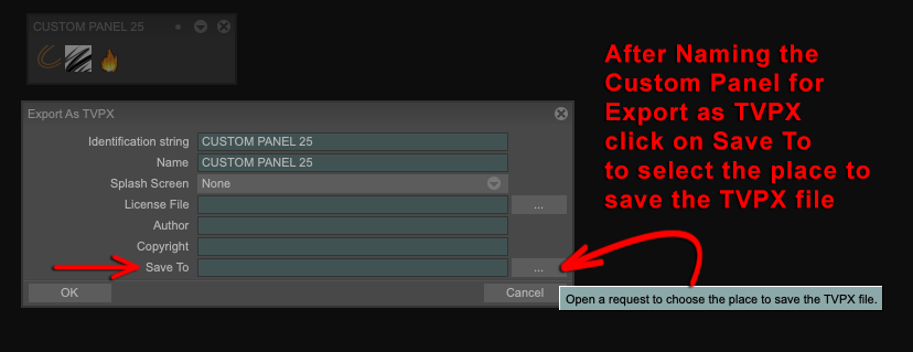

Then click Save To ... to set the location where the TVPX file will be saved.

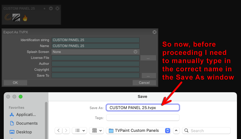

But when the Save As window opens there is a problem. The name of the file is the name of whatever file I had previously saved , instead of being assigned the name of the current file I'm saving.
Custom Panel shows name of PREVIOUS Export.png (60.98 KiB) Viewed 2047 times
So now I must stop and manually type in the correct name before saving it. The expected behavior is that TVPaint will automatically assign the name of the Custom Panel being saved , instead of the name of the previously saved file. (this bug exists going back to at least version 11.5 and has been reported before).
