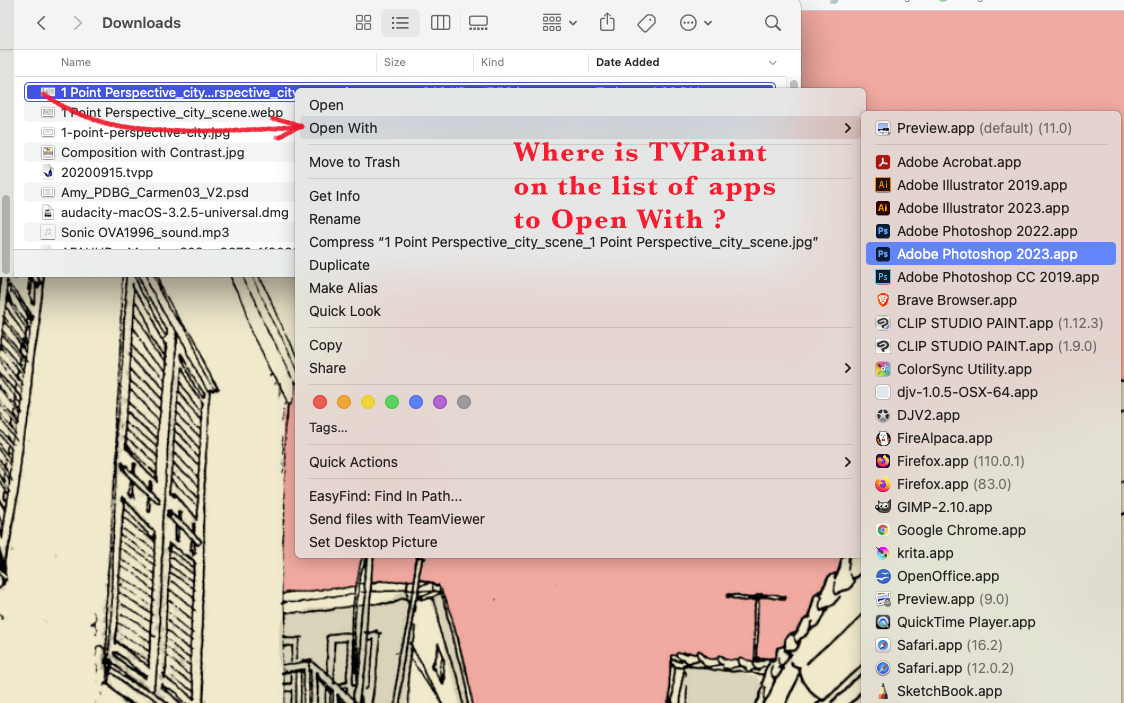

On Mac if you right-click on a file you get a menu with the option "Open With" , which allows the user to select any suitable application to open that kind of file.
So for example, if I right-click on an image file , .jpg, .png, .tif, etc. I'll be presented with a list of apps that could be selected to open it (such as Photoshop, Clip Studio Paint, Sketchbook, Krita, etc.) but I never see TVPaint as an option on the "Open With" list of applications and I cant figure out how to add TVPaint to the list. It's like TVPaint is invisible to the Mac, as if it doesn't exist.
Does anyone know how to add TVPaint to the "Open With" list (and keep it there) ?

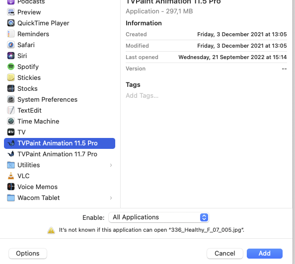

You can "right click" on the file, then choose "Get info", Scrol down to "open with", select "other" and find TVPaint (maybe you have to click "enable all"), after you selecte TVP, you see a checkbox below that says "change all". Check this box and it should work. Or was this not what you meant?

Oh wait. The first time I hit the "enable all applications" TVPaint became visible, from being invisible before. But the second time I tried it, it stayed invisible... And I can't make it visible again. This must be a Mac or TVP bug?...
But with some files I succeeded the way described.
And now after a couple of attempts, if I hit the "enable all applications, it was still half transparent but when I tried to click on TVP it was possible to select it...
This is a bit strange.
Screenshot 2023-03-07 at 11.05.15.png (85.27 KiB) Viewed 2863 times
Here you see it was possible to select it...
