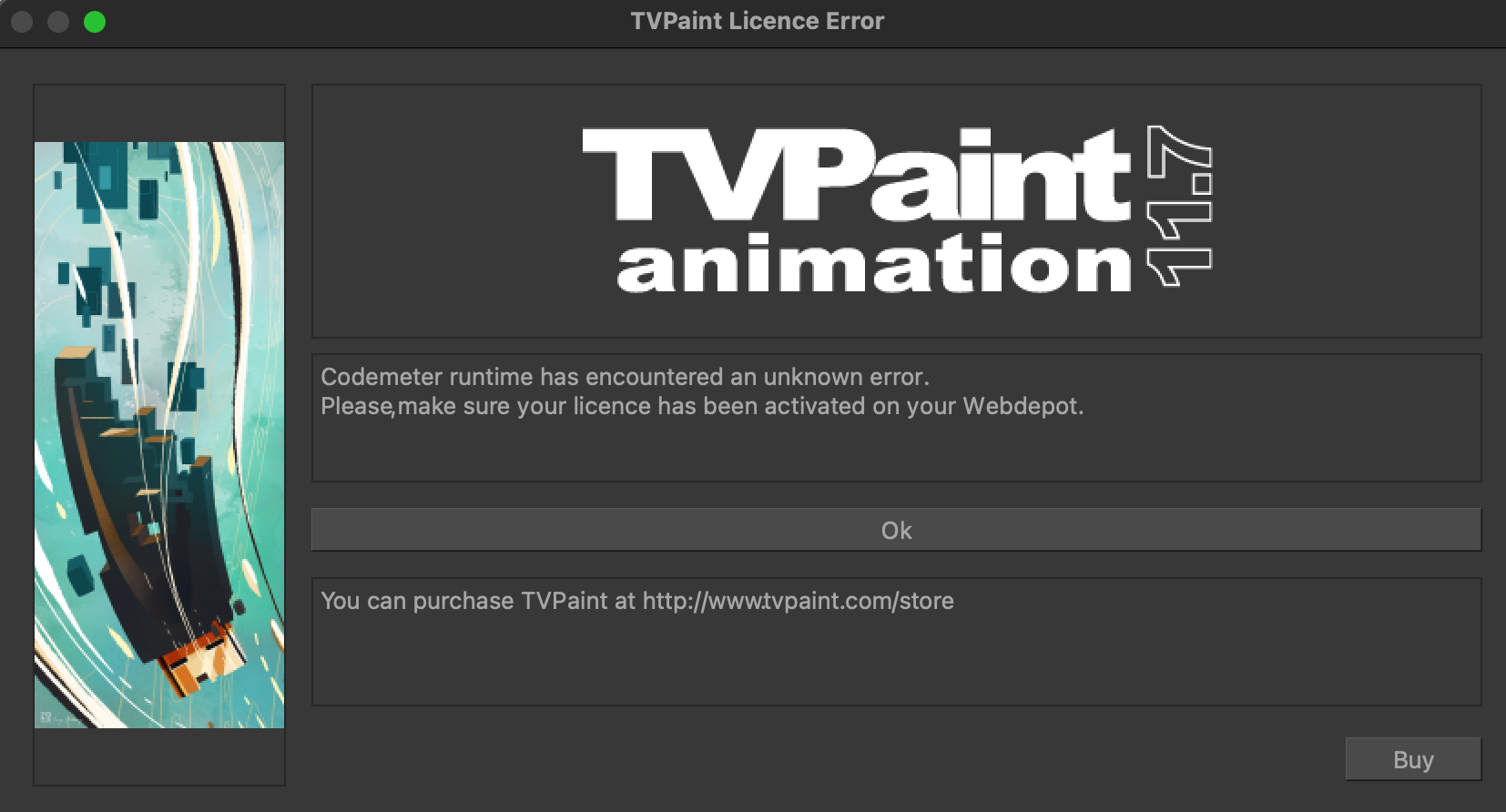

I have also been running TVP 11.7.1 on a Mac Studio, since last April. I haven't been getting crashes, but TVP does run very slowly, slower than it did on my 2013 Intel 27"iMac with much less RAM. (I'm guessing it runs in emulation, and is not written for the Apple M1 silicone?) It also gets a few bugs, like the eraser tool can be set to 100% but it is only erasing at about 90%, so I have to save, close TVP. and re-open and erase again. (That generally gets things working as they should.) So it hasn't been crashing, and I do get to save before closing and restarting.
Just yesterday, after not using TVP for 3 months, I tried to open TVP and found that it no longer recognises the CodeMeter is installed and won't open. There have been a couple of recent security updates to Ventura (Now at 13.3.1) this month, which probably caused this. So I am hoping for an update on the forum for dealing with Ventura.
Re: TVPaint crashing a lot
Hello Nick,
We are in the process of making TVPaint run natively on ARM Macs. From the tests we have made on our own ARM Macs, there wasn't any performance issue relying on Rosetta 2, so the slow downs may come from something else than this.
Regarding your CodeMeter issue: CodeMeter probably has been uninstalled from your system by a maintenance application such as CleanMyMac. I am myself on Ventura 13.3.1 and didn't encounter any issues with TVPaint (see the following thread here).
I will also handle the request you have made through our contact form to give you more details on how to solve your issue.
