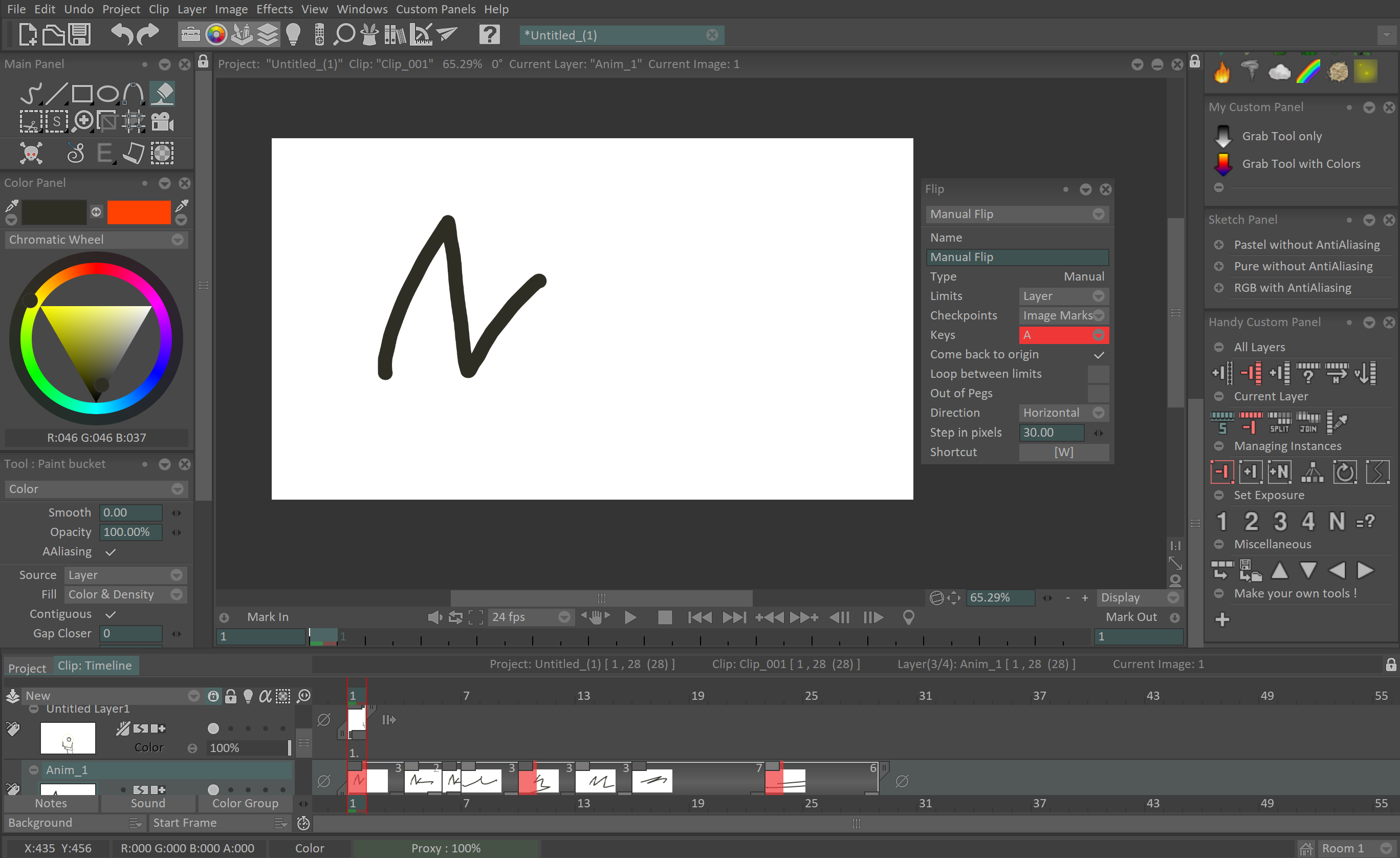

I just downloaded the last version. This panel does'nt work at all for me. I don't know if I have to turn on anything before using. I set different settings, tried with different Bookmarks, Imagemarks, but I can't see any change while scrolling the time-indicator or while play the project.
Can somebody please help me how to use this panel.

Hello, flips are meant to be activated by the pressing or holding down of a keyboard key, maybe you could post a screenshot of your Flips panel so we can check if something is missing.

Here you can see a screenshot. For example, here I want to skip some frames and see only the frames with red imagemark . But I don't know how to activate this.Dean wrote: ↑27 Jan 2023, 12:42 Hello, flips are meant to be activated by the pressing or holding down of a keyboard key, maybe you could post a screenshot of your Flips panel so we can check if something is missing.

.Here you can see a screenshot. For example, here I want to skip some frames and see only the frames with red imagemark . But I don't know how to activate this.Dean wrote: ↑27 Jan 2023, 12:42 Hello, flips are meant to be activated by the pressing or holding down of a keyboard key, maybe you could post a screenshot of your Flips panel so we can check if something is missing.
The shortcut key you're using for this Flip is W . So holding down the W key , with your pen cursor touching the surface of the tablet, as you move it left to right and right to left ... that action should flip between the images marked with the Red image mark.

Yessssss. It works. Thank you.
