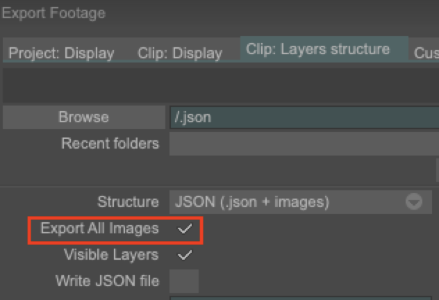

I can't replicate this issue. Did you make sure you had the 'Export All Images' option checked?

Matthieu wrote: 20 Jan 2023, 10:03 Hello,
Hi, I didn't notice that option before, but I just tried that one, I found out I can just choose either 'Export All Images' or 'Ignore Duplicate Images' , when I check one of them the other one would be unchecked, and I just tried the Export All images, with this being enabled I did can get the blank instance problem fixed because it exports all the images. But it raises two other problems: the first is that the file would be way larger exporting this way, the second is that the key in Aftereffect would be splited to every single frame instead of a proper timing from Tvpaint:
before 11.7.1, I could export JSON with 'Ignore Duplicate Images' enabled and import them into Aftereffect without any problem with the blank instances and I could get a file with small size and everything went well...
