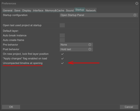

Also, in the new version 11.7.1 (released Dec. 22, 2022) there is an option in the Preferences to always open the scene with the Timeline expanded fully.
Screen Shot 2023-01-02 at 6.57.58 PM.png (23.42 KiB) Viewed 1772 times
