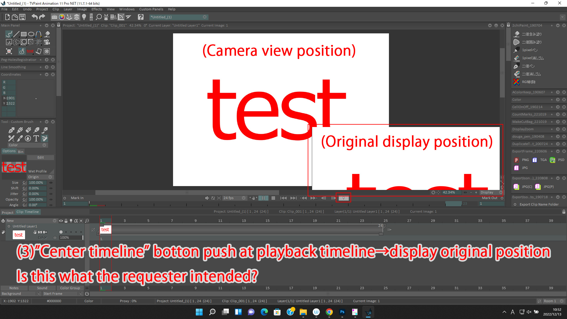

(3)
A button has also been added to center the timeline on the current instance and layer:
The current behavior of this added button was to show the state of the project view when pressed while the camera view was playing. Is it as intended by the person making the request?

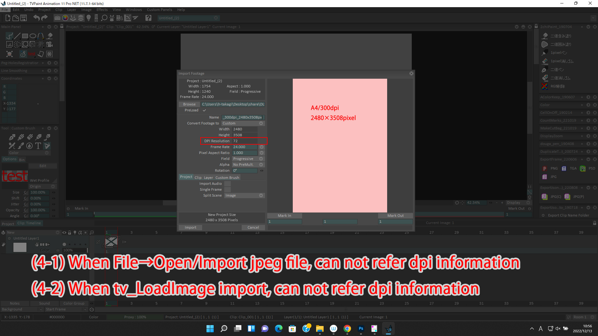

Import / Export: DPI values are now displayed when importing an image.
I imported jpeg and png with embedded dpi, but the display was "72", the same as in 11.7.0.

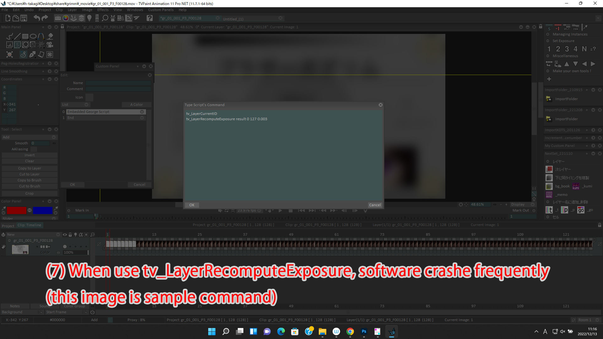

Changed the tv_LayerComputeExposure function to take into account the threshold: you only need to parse the last parameter to get the threshold value.
I tried to run tv_ReComputeExposure, but I confirmed the problem that it is easy to crash when the threshold is larger than 0.001. can it be mitigated?

Hironori Takagi wrote: 12 Dec 2022, 01:49 (3)
I am not sure I understand.
Hironori Takagi wrote: 12 Dec 2022, 01:49 (4)
We noticed that this only happens when you are drag'n'dropping the image in the software. If you use "File > Open Import", it will work fine.
We are on it, it should be solved for this week's hotfix.

Hironori Takagi wrote: 12 Dec 2022, 01:49 (7)
I tried to use tv_LayerRecomputeExposure, but didn't get a crash.
Can you tell me how you wrote the command?

(3)
I would like to know the intention of the person who requested this function because it is not what I requested,
but currently it is a function that displays the original position when pressed during playback in camera view.
I asked because I feel that it does not match the description of the tooltip.
(4)
As a result of File → Open/Import, png reflected dpi and jpeg was not reflected.
Also, our studio staffs and Japanese users use tv_LoadImage to import custom panels that I created, so I hope that this command will also be supported.
(7)
There was a comment in this post that 0.001 is the optimum value for Threshold.
viewtopic.php?t=14326
The probability of crashing seems to rise sharply when the value is larger than this.
Attached config, crashed at 0.003.

Hironori Takagi wrote: 13 Dec 2022, 02:34(4)
When importing into the current project, DPI value of the imported image will be changed to the project's DPI.
When importing as a new project, the new project's DPI will be the same as the imported image's DPI.
As tv_LoadImage loads into the current project and not into a new one, it's normal that the project where the image is imported does not change DPI.

Thierry wrote: 13 Dec 2022, 11:27
Okay.
I think that the newly set tv_ProjectGetDpi is a command to get the dpi of the current project without a factor,
but is it possible to get it from the image file by specifying iPath? This point is very important because it depends on whether or not continuous reading can be automated in one operation.
This is a very important matter, so I would like to ask you again.

Hironori Takagi wrote: 13 Dec 2022, 02:34(3)
This button is not to be used during playback. It's a button that help center the timeline view to the selected layer and the selected frame.
For example, let's say you have 10 layers and 100 frames. You have selected the third frame and the second layer. If your timeline view is currently showing the layers 6 to 10 and frames 55 to 100, then this button will center the timeline view to show the third frame and the second layer.

I provide a custom panel called ImportFolder mainly for Japanese users.This panel imports exported images (multiple folders or layer headers)
to TVPaint with one button and a few operations. It realizes the operation of arranging, for example,
when importing export images of 20 layers/folders, there is a clear difference in setup time.
Importing using this panel currently does not support maintaining dpi information, and staff who use paper or other applications have complained of incompatibilities.
I've introduced it several times in the past, but here's the latest version of the panel at the moment.
Thank you for the details, this is helpful for us.
We did create the George command, but we are having issues with the jpeg format at the moment. PNG works without issues however.
We will see what we can do with jpeg format, but I cannot promise it will be there for this week's hotfix.
Whatever the outcome we will keep you informed.

I understand (3).
I noticed that when the number of frames on the timeline is long, it is a function that allows you to instantly move to the location of the timeline bar (red line).
Thank you for your continued support regarding (4).

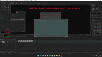

I and Japanese user found more bugs in TVPaint 11.7.1.
(11)When use tv_SetActiveShape “crop”, can not excute
Sorry for adding.
(Point (12) in my first post was incorrect. I apologize.)

Re: TVPaint 11.7.1 operation check
Post by Hironori Takagi »
Regarding the problem of (11), it was not resolved even with Windows version tvpaint 11.7.1 (Dec 16 2022).
Since it is a command that is especially used in my studio, I strongly hope that it will be resolved in 11.7.2.
