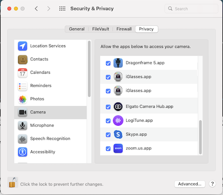

ernesttx wrote: 04 Dec 2022, 13:24 I'm not seeing a camera as well. I don't recall if TVPaint or OS prompted a message to "allow" camera connection. Checking System Settings > Privacy > Camera, I see 2 other apps that have access to camera and there does not seem to be an option to add a program to give access. I wonder does TVPaint request access to camera when installed? Also, wonder if re-install TVPaint will prompt request? I'm not sure how to re-install and have this WIBU thing see new install or do I have to re-install WIBU thing again and go through the hassle of reconnecting a license...ugh, why can't I be an artist and not tech support haha
I'm on MacBook Pro M1 Max, Ventura 13.1, TVPaint 11.5 (yes, I know update is there, but seems to be bugs in it and waiting on new update, also again, I'm not sure about re-install or update and this WIBU thing).

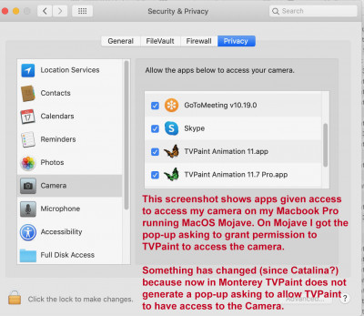

Same for me on MacOS Monterey 12.5, Intel Mac Mini, TVPaint 11.5.3 and 11.7. Under System Settings > Privacy > Camera, I see several other apps that have been granted access to my camera , but as you say, there does not appear to be an option to add a program (TVPaint) to give it access to the camera. I don't recall TVPaint requesting access to my camera.
I suspect that TVPaint video input has been broken since MacOS Catalina was introduced. As I recall , video capture in TVPaint still worked for me (with my Logitech webcam) when I was on MacOS Mojave ... but it's been a while since I needed to use Video-Input , so maybe it was broken before Catalina (?) . I didn't switch from Mojave to Monterey until earlier this year. (I skipped Catalina and Big Sur.)
Posts: 4269
Re: Video Input not working in 11.7 (or 11.5.3)
I think you are on to something that may prove to be the solution to the problem.
Because I know that Video-In was still working when I was running MacOS Mojave, I wonder if the problem is that on MacOS Monterey (and Big Sur and Catalina) with the stricter security settings, TVPaint does not present a pop-up to the user requesting permission to use the camera , so in Privacy & Security system preferences TVPaint does not have permission to access the camera ? In my Privacy & Security system preferences I can see a number of different applications that have been granted permission to access my camera, but TVPaint is not one of them and there is no way to manually add it to the list of programs with permission to access the camera.
Access Camera in Mac System Prefs.png (75.5 KiB) Viewed 15601 times

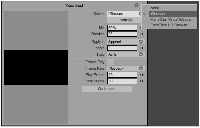

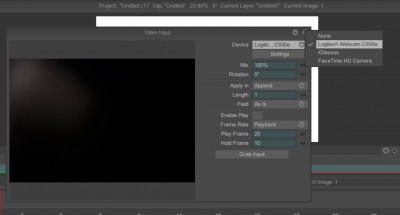

NOTE: on past versions of TVPaint when I was running my webcam through an app such as iGlasses (which allows the user to manually adjust exposure/white balance/focus on the webcam) TVPaint could "see" iGlasses as an available video input device, so I could select iGlasses as the input device. Now Video-In shows "None" as the only choice under device.
Screen Shot 2022-12-06 at 8.46.52 AM.png (27.11 KiB) Viewed 15600 times
This is how it used to appear in the Video-In panel, along with other available capture devices :
Screen Shot 2022-12-06 at 8.56.39 AM.png (53.57 KiB) Viewed 15595 times

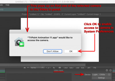

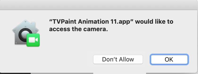

NOTE: I went back to check on my old Macbook (running MacOS Mojave) to confirm that TVPaint had this pop-up asking to give TVPaint permission to access the camera. It does have the pop-up:
Screen Shot 2022-12-26 at 5.41.51 PM 2.jpeg (58.26 KiB) Viewed 15236 times
This problem seems to be the result of the stricter security system in Catalina/Big Sur/Monterey because TVPaint 11.7.1 has no problem finding and using my webcam on my old Macbook running MacOS Mojave . (and running on MacOS Mojave TVPaint 11.7.1 can also access webcam controller software such as iGlasses , Elgato Camera Hub ,or CamTwist that are set up to use the webcam as a source. On Monterey these webcam controller softwares do not show up under 'Device' in the Video-Input panel like they do in Mojave.) I believe the answer is in the Apple AVFoundation guidelines for configuring the info.plist for the application. https://developer.apple.com/documentati ... ture_setup .

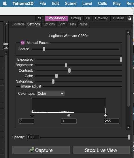

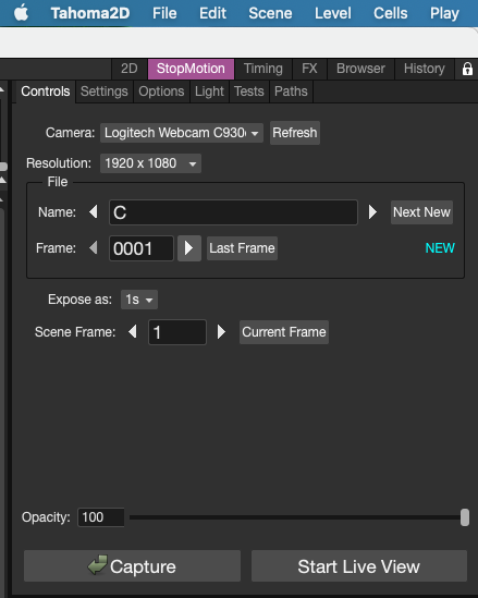

I noticed that the recent build of the open source sofware Tahoma 2D (an offshoot of OpenToonz) now has support for camera capture. Because the source code is open it may be worth having a look at the code to see how they added this function to Tahoma. It might provide a clue to fixing Video Input for TVPaint (?) .
https://github.com/tahoma2d/tahoma2d/tr ... libgphoto2
Screen Shot 2023-01-21 at 10.11.48 AM.png (55.59 KiB) Viewed 14895 times
Screen Shot 2023-01-21 at 10.12.01 AM.png (70.21 KiB) Viewed 14895 times
Screen Shot 2023-01-21 at 10.13.10 AM.png (62.05 KiB) Viewed 14895 times
