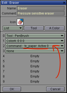

otherwise, you can use Custom Panel buttons,
- edit your "pencil" tool and add this command line (type Script Command) :
- edit your "eraser" tool and add the command line : (see pict.)
Code: Select all
tv_paper Active 1
Code: Select all
tv_paper Active 0
of course, you can also assign [Tools: Toggle Paper] to a shortcut, but imo, you shouldn't need it.
my 2 cents.
- Eraser+PaperOff.png (10.73 KiB) Viewed 8541 times
