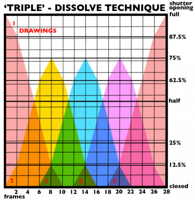

Basically you have three or more passes in camera where each drawing is faded in and out, the following passes start with an offset so in the end at every given frame somethig adds up to 100% exposure. Hans Bacher gave a nice diagram on his website https://one1more2time3.wordpress.com/20 ... dissolves/:
Note that in each frame, all passes add up to 100%. You can use your own values (like I did), but you get the idea.
