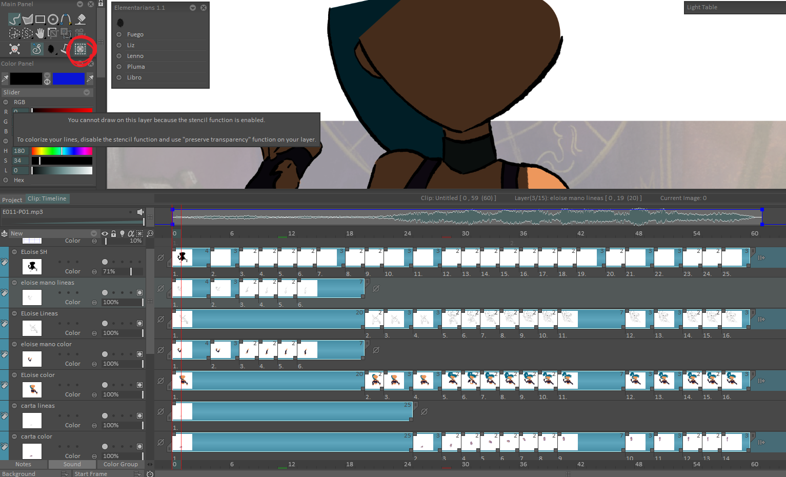

Hi,
In TVP 10 we were able to draw on a layer when the layer stencil was enabled. In my opinion this was the way it should be.
In TVPaint 11 this was changed. Every time I draw on a layer where the stencil is enabled, I get this popup that I can't draw on it. Why?
When I'm explaining the stencil function to interns I always tell them: " You can draw on the pixels of all layers where the stencil in enabled"
Now I have to say: "...Except on the layer you are currently working on...." Confusion!
I really don't understand the reason behind this change. I heard that it should be clearer for new users. But in my opinion it's more confusing.
Can someone explain why the new method is better.
My request: change it back to the way it was! Thanks! :)

Re: Be able to draw on layer when stencil is enabled
Post by Xavier »
Guys, sorry I'm not very used to the stencil mode. Would you mind sharing a project, so that to show how it could be used ?
I'm going to test with TVPaint 10 too, so that I can see the difference.
condepablo
Posts: 60
Joined: 21 Nov 2019, 01:32
Post by condepablo »
Please! this happens all the time, I can´t have a fluid work :cry:
if I have disable stencil on the main panel, that should be the main controller
Joost
Posts: 439
Joined: 24 Nov 2011, 13:16
Post by Joost »
condepablo wrote: 09 May 2022, 00:50 Please! this happens all the time, I can´t have a fluid work :cry:
Yes, exactly this!
It's one of my biggest TVP frustrations.
I constantly hitting my action "disable all stencil" just to avoid this popup. But after that I have to turn them on for every layer again...
But the TVP team promised to fix it in the next version, right?
(To be able again to draw on the layer where stencil is turned on, like in previous versions of TVP...)
TVP Pro 11.7.1
