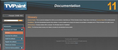

This recent video includes a section on installing the WIBU license and rehosting the license. Important to follow each step in the video to properly install the WIBU CMContainer license and host the license on your computer through the license depot link (TVPaint will send you the license depot link when you switch to WIBU).
https://www.youtube.com/watch?v=VjaiYmyVt2c
Same as the instructions in the User Guide in the section Download and Install:
https://www.tvpaint.com/doc/tvp11/index ... u-glossary
I don't know of any special system requirements for WIBU . No one from TVPaint ever mentioned any special system requirements when I switched over to WIBU. I'm running TVPaint 11.5.3 on a 2013 Macbook running Mac OS 10.14 Mojave. I think the only system requirements are the same system requirements for running TVPaint 11.5 : it needs to run on Mac OS 10.11 El Capitan or higher and have a minimum of 4GB of RAM .What are the system requirements to use TVP with WIBU?
No. (I actually never thought about it before , so I just tested it by disconnecting my computer from the internet . TVPaint continued to function normally).Does WIBU require being connected to the internet during work in TVP?
I don't know of any reason why you would also need the USB dongle if you have the WIBU license. WIBU allows you to transfer your license to a different computer just like you could transfer your license by plugging in the dongle to another computer . (rehosting the license to a new computer does require a internet connection while you're doing the rehosting on the license depot.)What could be a reason to buy a USB dongle (for an additional 75 EUR)
