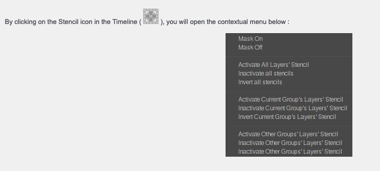

This confusing terminology about "Masks" persists in the User Guide. In the TVPaint interface the terminology used is Stencil . In the TVPaint User Guide the section refers to "The Masks" and uses the term "Mask" rather than "Stencil". The user searching in the User Guide for how to enable and use Stencils will not find anything relevant by searching for Stencils because the information they seek is listed under "Masks".
Other sections of the User Guide refer to the term "Mask" , but should read "Stencil" to be consistent with the interface. For example the section on Preserve Alpha Channel

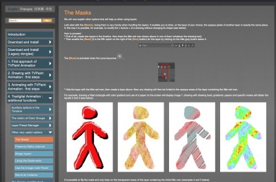

D.T. Nethery wrote: 26 Sep 2021, 19:19 In the user manual the function of the Stencil is described as "Mask". If a user seeks for "Stencil" in the User Manual they won't find this function because it is categorized under "Masks" in the User Manual. This is confusing.
https://www.tvpaint.com/doc/tvp11/index ... ions-masks
In the user manual this is what you will find, describing the function of "The Masks" , "Mask ON" and "Mask OFF" (but also referring to the function as "stencils")

But in the current TVPaint interface the term used is "Stencil" , not "Mask" --

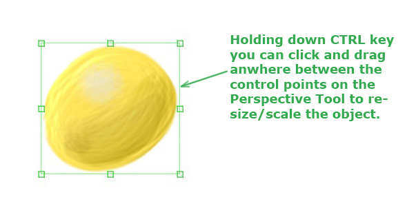

Here is something to add to the User Guide in the section on the Transform tools , specifically the Perspective Tool:
https://www.tvpaint.com/doc/tvp11/index ... erspective
When using the Perspective tool, hold down the CTRL key ,then click and drag anywhere except on one of the tool's control points to re-size/scale the Perspective frame and its object.
Also, when using the Perspective tool, click and drag anywhere except a control point to move the perspective frame and its object side to side or up and down.
(I've used TVPaint for years and only recently learned this tip about holding down the CTRL key to scale an object using the Perspective tool, so you don't have to switch back to the Transform tool to scale an object that has been distorted using the Perspective tool. That information about using the CTRL key for resizing is not currently in the User Guide.)

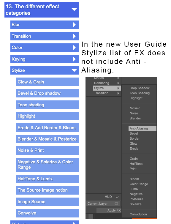

In the new User Guide under 'The different effects categories' - Stylize , the list of stylization FX does not include Anti-Aliasing FX.
Also, I would suggest that the FX listed in the User Guide should be in the same order of FX as listed in the FX Stack menu. (or else order of FX listed in the FX Stack menu should reflect the same order as listed in the User Guide , although I think it will be more trouble to change them in the FX Stack menu than to rearrange the order in the User Guide)
Screen Shot 2022-10-13 at 10.12.58 AM.png (68.12 KiB) Viewed 64357 times
If the FX in TVPaint's FX Stack menu is named Convolution , then the User Guide should have Convolution instead of Convolve.

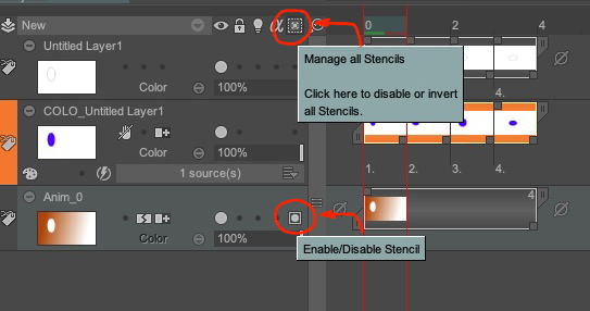

In the new User Guide the inconsistent dual-terminology of "Stencils" and "Masks" has been resolved , so the function now seems to be referred to consistently as "Stencils" , except in the section covering Stencils (see: https://www.tvpaint.com/doc/tvp11/index ... ions-masks) it still has a screenshot which shows "Mask On" and "Mask Off".
Screen Shot 2022-10-13 at 10.29.35 AM.png (38.19 KiB) Viewed 64355 times
It is corrected in the TVPaint interface, where the menu shows "Stencil On" and "Stencil Off". So the screenshot in the User Guide should show the same.
Screen Shot 2022-10-13 at 10.29.21 AM.png (20.13 KiB) Viewed 64355 times
Nice catch, I will update those screenshots, thanks :-)
