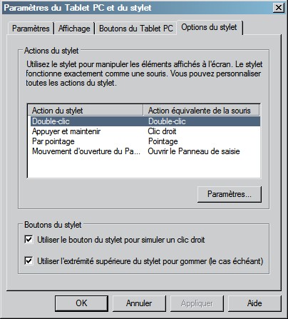

In fact, it comes from the tabletPC settings.
I had exactly the same problem with my Toshiba Portege M400 : the system was trying to find how many time I was hitting the screen with my stylus, so my strokes were distorded each time I was sketching.
I had an option, that was enabling the right mouse button if I was not moving the cursor dring the two first seconds ... Once this option was turned off, everything worked fine.
Interface in french, sorry ...

Fabrice, you genius, it's fixed. Thanks.
And now I finally have smooth subpixel drawing on my TabletPC, from any screen orientation.
