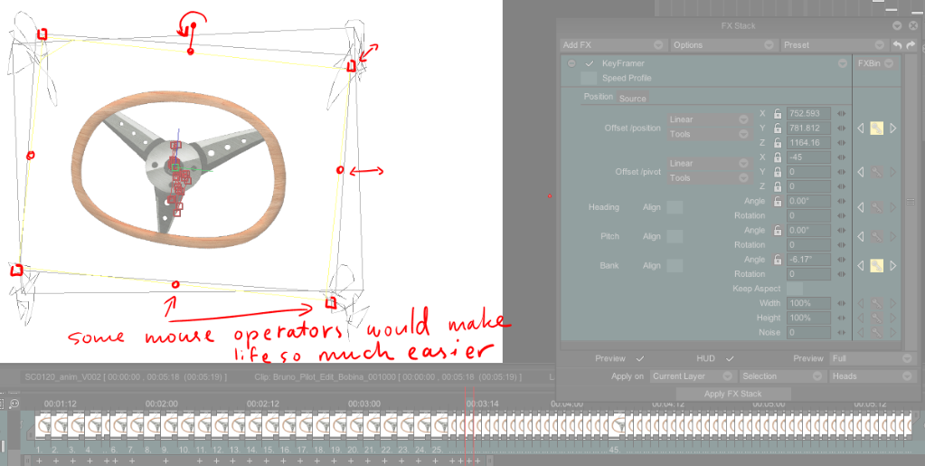

- It would be really helpful if on all the motion effects there were more visible and more precise on screen controls for the mouse or pen, because many important controls are very cumbersome to use.
- For example - in the KeyFramer FX I can see the yellow box and use SHIFT and/or CTRL -click to manipulate some of the inputs like Bank or Pitch or Pivot (and this method is not precise, because the mouse feedback is just too fast). And it will create a key automatically. But there is no way to change the position that way. It is possible to create a new, or click an existing keyframe on the path and then move it with mouse, but here is the problem: if there are too many keyframes on the screen (see screenshot), it's impossible to select the right one, because they often overlap, especially if there is no path at all and all keys are in the same spot. The only certain way to do it is to select the necessary key in the timeline. But this is just tooo long - too much going back and forth from stage to timeline and back (by the way the Z depth is impossible to control with any clicks whatsoever even after creating a keyframe - the only way is manual number input)
- Another example - the Stabilizer - this one doesn't even have a yellow box, so there is no way whatsoever you can easily choose anything on the screen.
- all these SHIFT and CTRL click functions are not in the User guide - need to be updated.

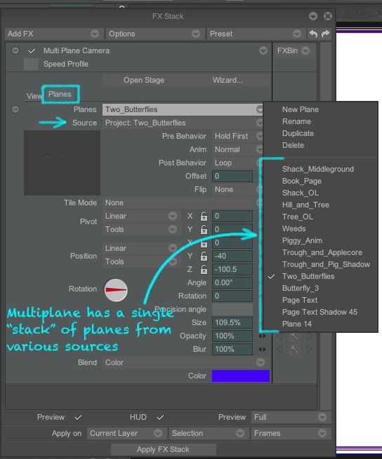

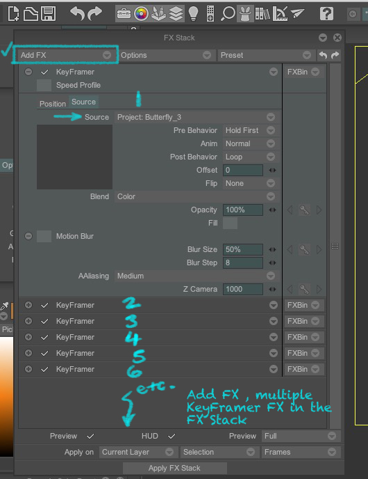

Very true. This is a point that could be emphasized more in the User Guide and Tutorials , in my opinion. I have come to the point where I almost never apply FX directly to the original layer, but instead I apply FX on a new layer (create Duplicate Structure layer is very useful for this) with the Source set to the original layer or Source set to another Project or Clip, or Source set to Images stored in the Image Library . Image Library is for me one of the most powerful features of TVPaint , but seems to be little known or understood by many users. The fact that you can use images stored in the Image Library as Source images to create FX sequences makes it much more efficient to create Multiplane Camera shots , for just one example .
I have worked on Multiplane scenes where I have layers of still artwork in the Image Library (originally created in Photoshop, transferred into the Image Library) , plus multiple layers of animation saved as DEEP (.dip) files , with each of the animated DEEP sequences open as separate Project tabs. In the TVP file where I'm compositing the final scene I have the Multiplane Camera FX with the various plane Sources set to either images in the Library or to the animated sequence projects (DEEP files). To keep all of these source files from being lost I create a single folder where the original Photoshop files , the various DEEP files and the .TVPP file are all stored together (similar to how an After Effects project has a folder called Footage where all the source files are stored).
The Multiplane allows you to add multiple planes into a single Multiplane FX , but if you're using this multiple source files from Image Library/Clip List/Project List technique with the KeyFramer then you have to open a new KeyFramer FX for each layer , so you literally have a "stack" of KeyFramer FX in the FX Stack one on top of the other (the position of these Keyframer FX in the stack can be changed by dragging them up or down in the stack.)

Soom wrote: 15 Nov 2021, 01:19 UPD: After Peter's explanation I will rephrase this feature request:
