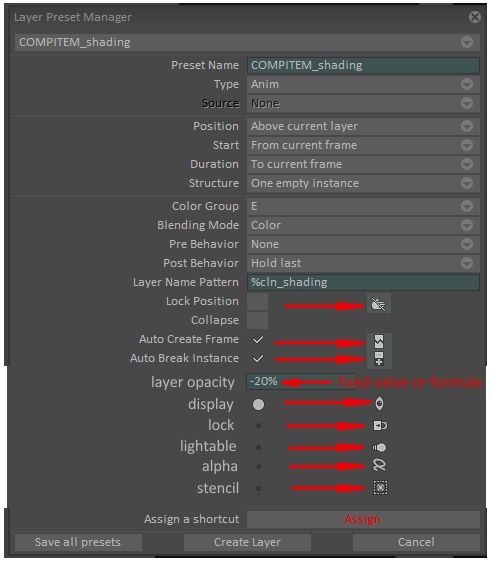

I am missing options in the layer preset manager.
Why not offer all the standard layer settings there?
layer preset manager.png (32.71 KiB) Viewed 7626 times
the layer value could be set to a fixed value or make it a pattern... a function on the current layer.... say 20% less then the current layer for instance
- duplicate layer should also be added in the options here, its also in the layer menu but you should be able to create a duplicate layer WITH all the other customizable layer presets
- reverse order should also be added in the options

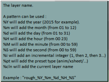

Currently these are the naming patterns available and i need some more:
layer preset managepattern.png (60.82 KiB) Viewed 7626 times
Since we actively use colorgroups and names in our pipeline, it would be great if we could get a colorgroup based on the name or visa versa.
so some additional naming patterns could be:
%G will add the colorgroup name
%C01 will add custom string 01
(not sure if that makes sense...i'm not a programmer)
else add an option for a custom layer type name. because it says now:
%pt will add the preset type (anim/xsheet...) but in fact there are only two types: Anim and CTG (xsheet was abandoned)
so if there would be a box where you could designate your own type... say for instance layout, storyboard, rotolater, colorlayer.... whatever
in combination with the Presetname box it would make for a very versatile layernaming situation.
but i suppose those are not ' official' tvpaint layer types ( there are only 2) we might have to name them different,
or split up the name pattern into two parts? i don't know what would be the most logic from a programming standpoint
now it works like this:
firstpartofthecurrentlayername_rotolayer
apply new layer:
firstpartofthecurrentlayername_rotolayer_colorlayer
but off course instead i need this result:
firstpartofthecurrentlayername_colorlayer
So ideally i also need something to trimm down the current layer name... to only get the part before the first underscore:
-%... that would delete everything from the current layer name that comes after the first underscore "_"
