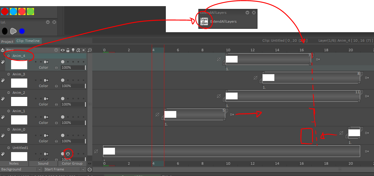

- condepablo
- Posts: 60
- Joined: 21 Nov 2019, 01:32
Re: stretch layer length
Thanks Svengali!
I was testing the script. but I have some observation that could make this one step foward!:
1-apply to selected layers instead on all (or at least preserve the locked ones)
2-use as final frame the last frame on selected layer
3-add the posibility to shrink too
example attached
example attached
- Captura.PNG (58.91 KiB) Viewed 14223 times
